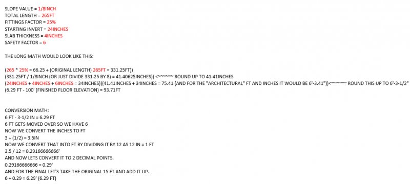

hey all,
so I am new to getting into writing lisp routines. I have done some searching around and I found it once, yet like a smart guy I didn't save this information. but then you have a lisp that you are looking at (not one that I wrote) and you are seeing the following:
ah:getval5 "Line 1" 5 4 "0.9" "Line 2" 8 7 "wow" "Line 3" 6 4 "123" "Line 4" 6 4 "456" "Line 5" 6 4 "789")
(sorry I tried to do the code pasting the correct way but it wasn't allowing it.)
what are the numbers after you see "line 1" "line 2" ETC. see attached screen shot.
also can someone tell me where I can get this information? I know that it is out in the google world but I for the life of me can think of the term to use nor where to start looking at. can someone flash a light on this and show me the direction?
thank you all

Ok now the explanation, 1st up its important that this the code is a Library routine and has been designed to be used with any lisp rather than an individual hard coded DCL.
When you make a dialouge DCL one of the variables is in the size of a input box.
The lisp has a defun that requires some information to be passed to it
(defun AH:getval1 (title width limit def1 / fo fname)
AH:getval1 is name of defun
title is just that the Title that appears at the top of the DCL
width is the number of characters displayed for the input box
limit is the actual number of allowable characters that can be entered
def1 is a default value entered into the DCL.
(ah:getval1 "Line 1" 5 4 "-") this is a single dcl variable box

So with all this being said, the 5 4 in (ah:getval5 "line 1" 5 4 0.9) is that referring to line 5 and line 4 within the dcl string? And then the numbers between " " is the size and or what is to be out/calculated into the line/box?
Am I understanding that correctly?

I guess 2hat I am really wanting to know what the numbers (5 4 8 7 6 4) are associated with? What are they refering to?
Because unless you know this then you can write is sideways, it will still just be random numbers.
To the width and the edit_limit attributes of each edit_box tile, although you have to familiar enough with DCL to understand.

so here are some of the last modifications that i made and i have to super close i think. but then again i could be totally wrong. i took what you said about auto filling all the attributes and took them away.
so i am running into an error code still and i see where is it telling me that the issue is but not sure how to correct it.
error:Command: (LOAD "I:/WORKING LISP ROUTINES/slope test2.lsp") too few arguments in SETQ: (SETQ PERC (ATOF VAL4) (SETQ FMTVAL (RTOS X 2 2)))
here is my current mess that i have made.

To clarify (ah:getval5 "Line 1" 5 4 "0.9" "Line 2" 28 27 "wow"...... would mean the 1st box is 5 characters wide accepting 4 characters as input, the second box is 28 characters wide accepting 27 characters.
Will check code soon.
Found obvious mistake when you insert your block has 8 attributes but your supplying 10 answers in the code.

ok so i havent been able to look at this for about a week due to cad not working right on my home computer.
but looking at this again it seems that i have made some changes that just are not working at all. so i started back with square 1 on the lisp that you wrote in the beginning.
; simple example of filling in a block attributes with calcs
; by Alan H Dec 2017
(defun c:pipe-calc ( / len ans div slabd inv safety tot totslope)
(if (not ah:getval5) (load "getvals1-5"))
(ah:getval5 "Enter desired slope 1/x 4 8 16" 5 4  "4" "Enter length " 5 4  "50" "Enter inv " 5 4 "24" "Enter slab depth" 5 4 "4" "Enter safety " 5 4 "6")
(setq div (/ 1.0 (atof val1)))
(setq len (atof val2))
(setq inv (atof val3))
(setq slabd (atof val4))
(setq safety (atof val5))
(setq totslope (* len div))
(setq tot (+ (+ (+ totslope inv) safety) slabd))
;(alert (strcat "Value is " (rtos div 2 2)  "\nLength is " (rtos len 2 2) "\nTotal slope is " (rtos totslope 2 2) "\nInvert is " (rtos inv 2 2) "\nSlab depth is " (rtos slabd 2 2) "\n\nTotal overall is " (rtos tot 4 2)))))))
(command "-insert" "PIPE-CALC" (getpoint) 1 1 0  val2 val3 val4 val5  (strcat "1/" val1)  (rtos TOT 4 2))
(c:pipe-calc)
with this i wanted to see if maybe i could understand this a little better. i want to be able to add a finish floor elevation, total length, fittings factor(this would be 25%, as we have to multiply the total length by 25% to get the true total length), slab thickness, safety factor and have this give me an overall depth. in feet and inches. last thing that i want to be able to have is to take the total O/ALL and convert this to absolute feet (engineering feet and inches example: 91.25 feet below finished floor)
sorry for the example but i want to make sure that i am explaining this correctly so i am not leaving anything out.
i have taken the block that i updated/modified and removed all the notes that i had on there. just to simplify it and make it a little less messy. for now i can add to this later.
sorry if i am sounding like a dumb**** i really am trying to learn what i can with this to understand it better.
thank you again for all your help.

yes it does sound like i am not understanding it at all. my oh my this stuff is very complex for someone just starting out. but with all the changes that have happened in this post i figured i would add back in the math that i am looking to achieve.
so here is the values that i am using (just as an example) along with the long math and conversion math that we use (or like me i use google to get the math done for me.)
do you think that it would be easier to have the conversion part of it be a secondary lisp?

The best help I can give you now is this:
It seems you have enrolled in the Copy-Paste School of Lisp Programming.
I advise you to leave that 'institution' as soon as possible. ;)
Lisp is like a HP calculator polish notation tell what math 1st then supply the 2 aruguments / x y divide x by y
You need to look at your code it bit closer count the brackets on each line make sure they balance open = close remember though a IF will say have an extra at start but an extra at end.
Amost forgot watch out for typos prec v's perc in your code.
