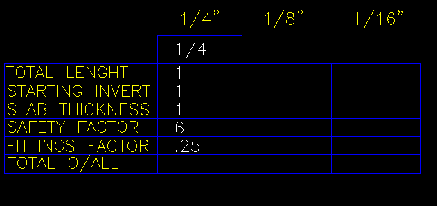

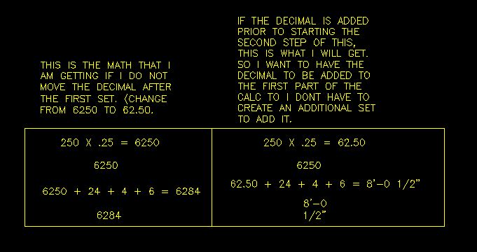

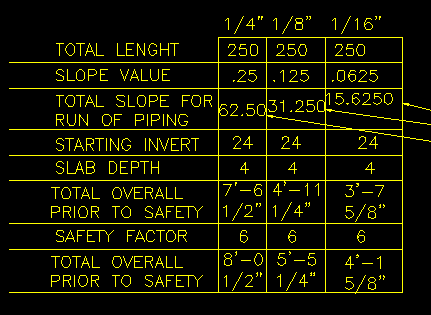

hey all,
i found a lisp that i am totally digging. i wanted to try and tweak this a tad and see if i can make this better. this lisp was done by the one and only Lee Mac. (i first sent him an email regarding this to try and hit the source first.)

this is a text calculator. i am using this to calculate my inverts. here is the email that i sent to him regarding what i am looking to do with this code.
I work with plumbing drawings (2D) and I use all kinds of different math. But when I am working with the lisp of yours and let’s say I do 250/8 = 31.25
or if the text was to read 250*.25 = 31.25. When I run your lisp with those numbers it is giving me a value of 31250 and that is it.
Would it be possible to modify this to have a decimal be here 31.250?
Here is what my calculation would need to look at to calculate slope. 250'/8 (this is for 1/8" slope and would be 4 if it is for 1/4" slope)
= 31.250" + 24" (this would be my starting depth of piping) = 55.250"+ 6" (we use this for safety or as a just in case thing) = 61.250"
or 5' 1.25" below finish floor.
I have been searching for something to be able to enter the total length (250) have it prompt for 1/8 or 1/4 (4 or  and then ask for
stating depth of pipe (starting invert) and then ask if we want to add the safety. (y/n) and then bingo you get either 61.250" or 5' 1.25"
and I would just know that this would be below finished floor or if we are able to do this math to show this as negative (-61.250 or -5' 1.25")
i am still learning code and i still have no clue how to word things nor where to place it within the code. attached are a few screen shots that i have taken to show you the results when running the lisp (plus steps within) i also created a very simple block to keep everything simple. let me know your thoughts!
thanks for looking.

The answer for you is a custom lisp this way the maths is done correctly. What you want is not that hard, the question is how do you want the output, looking at image it could be a block, a table or lines and text.
For me a block would be the easiest as you would answer 4 questions length, invert, depth, safety. The rest would be filled in. If you could create the block with the text style and height set then the code could follow. Make the lower left as insertion point start at 0,0.
Just make the attributes like len1 len2 inv1 inv2 etc
Edited by BIGAL
I would agree with you! If I was able to put the starting invert (xx"BFF), Slab thickness, total length of the piping run, the safety factor and then last be the slope you want either 1/4" 1/8" or 1/16"
Problem is I don't know how to write that up. And have it actually work. If I tried my computer might laugh at me and then just show me the middle finger. Lmao
Ok re read that and I see what you are saying. I am out for the weekend but I will create the block and on the side I can write the information you stated.
Thank you again
@dnovember99:
The issue is caused by Lee Mac's ParseNumbers function that does not recognize ".25" type numerical strings.
Below is a replacement function that does.
; (KGA_String_ParseNumbers "12'3/4\" ABC 5.6D.7.8 -9-10.0") => (144.75 5.6 0.7 0.8 -9 -10.0)
(defun KGA_String_ParseNumbers (str / N_Str_To_Num ret sub)
 (defun N_Str_To_Num (str)
   ((if (not (wcmatch str "*[~-0-9]*,-,?*-*")) atoi distof) str)
 (setq str (vl-string->list str))
 (repeat (1+ (length str)) ; 1+ to ensure processing of final sub.
   (cond
     ((<= 48 (car str) 57)
       (setq sub (cons (car str) sub))
     ((vl-position (car str) '(34 39 45 46 47)) ; (vl-string->list "\"'-./")
       (if
         (or
           (vl-position (car str) sub)
           (and sub (= 45 (car str))) ; "-" has to be the first item in sub.
           (setq ret (cons (N_Str_To_Num (vl-list->string (reverse sub))) ret))
           (setq sub (list (car str)))
     (sub
       (setq sub nil)
   (setq str (cdr str))
 (vl-remove nil (reverse ret))

AMAZING WORK.
so i brought this up with a few guys that i work with and they love it! they did want to see if there is a way to add in 25% to the final number. i should have thought about this, but the reason is if we have a total length of pipe of 300' that is just the piping, the 25% would add in the fittings that would be there.
i was also thinking that i could change out the block and remove the 1/4" 1/8" and 1/16" text on top and the two columns to the right being that this doesnt calculate all three of them. which is fine by me. i like it this way.
so i tried to go in a tweek what i thought might help this work to take the length x 25% = xxx
i just thought i would give it a shot before i came back. let me know where i am going wrong? oh and to the block i added another row to have the fittings factor.

i am sure that what i tried to change is totally off and wrong but i wanted to at least try. thank you again for your help with this
A couple of things, the block was not well drawn regarding the line work so I would start again horizontal and vertical lines in the pattern required, the tot 0/all needs a wider box I found.
I would add back in the (if (not AH:getval5) line so it loads the dcl code when required.
The getvals1-5 I have just added more defuns so you would need to add the 6 line option just copy the 5 and add the lines make it ah:getval6.
Also you need to add the fiiting factor to the -insert ..... (strcat val6 "%") add an extra attribute "perc"
(write-line "spacer_1 ;" fo)
(write-line ": edit_box {" fo)
(write-line (strcat "    key = " (chr 34) "key6" (chr 34) ";") fo)
(write-line (strcat " label = "  (chr 34) title6 (chr 34) ";"  ) fo)
(write-line (strcat "     edit_width = " (rtos width6 2 0) ";" ) fo)
(write-line (strcat "     edit_limit = " (rtos limit6 2 0) ";" ) fo)
(write-line "   is_enabled = true ;" fo)
(write-line "    }" fo)
(mode_tile "key6" 3)
(set_tile "key6" (setq val6 def6))
(action_tile "key6" "(setq val6 $value)")
