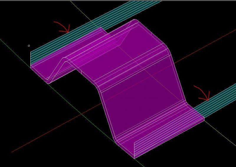

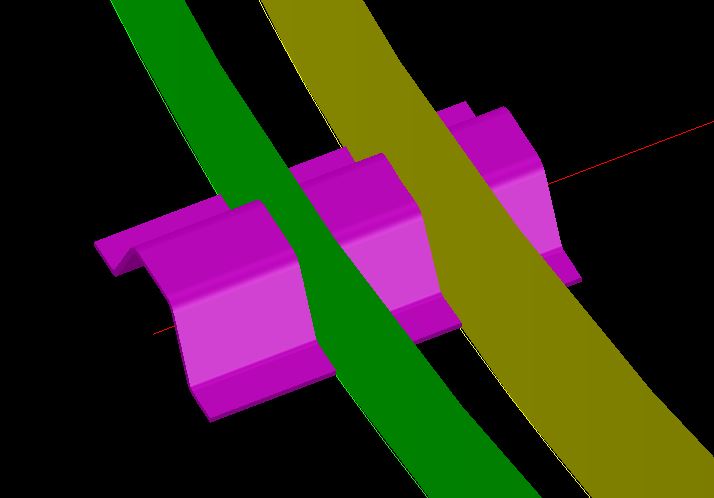

Trim both circles that form the O.D. and I.D. so you end up with two arcs. Extrude the arcs up and through your extruded profile. These extruded arcs are surfaces that will be used to slice off portions of the extruded profile.
You will be using the SLICE command with its Surface option to accomplish this task. When executing the SLICE command pay particular attention to the command line and what AutoCAD is both tell and asking you.
This should be the result.

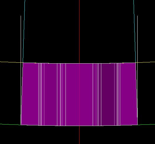

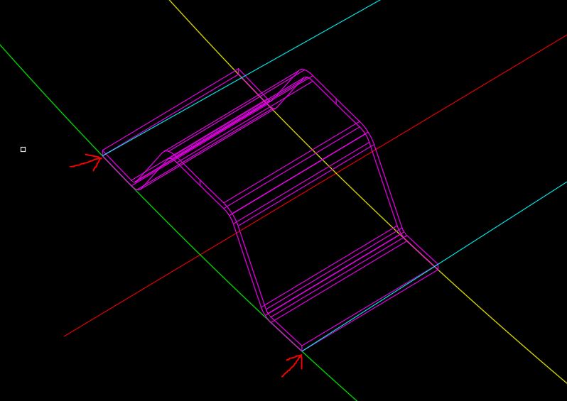

Draw two taper lines (cyan colored in image below) from the center of the the arcs to the outside corners of the extruded profile. These will be extruded upwards to slice off the edges of the profile. Again, you will be using the SLICE command with its Surface option to complete this task.
Taper lines (which are surfaces) extruded through profile.
Once you have trimmed the extruded profile with the taper lines you can array it. You are familiar with polar arrays are you not?
Top view of tapered profile before executing a polar array. Visual style is X-ray.

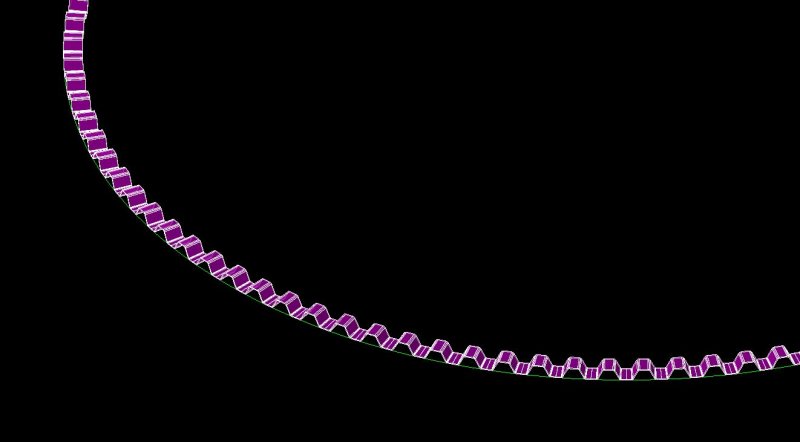

Final steps. Execute a polar array, explode the array (since it will be a block, then union all the ridges to form a single 3D solid model.
