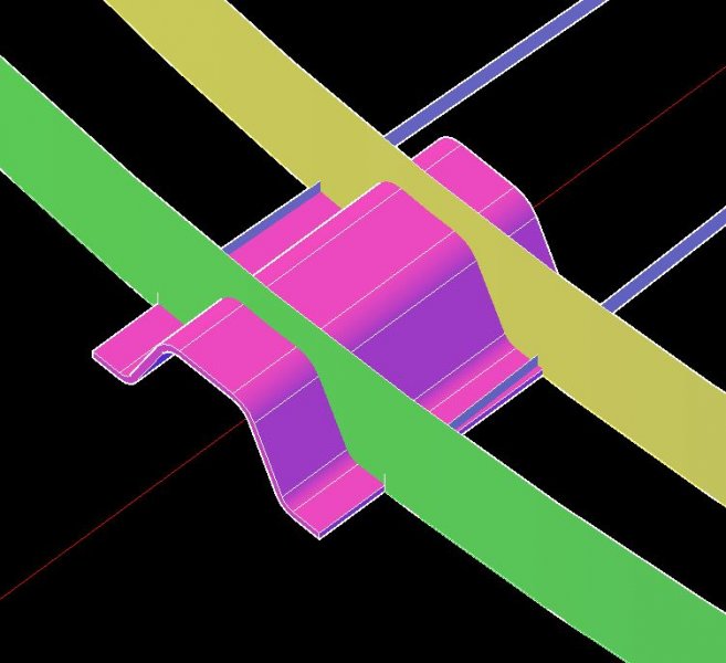

basty Posted November 22, 2017 Posted November 22, 2017 How do you create an oil ring (please see below image) in AutoCAD? Quote
ReMark Posted November 22, 2017 Posted November 22, 2017 Doing it in 3D create one ridge, extrude it then use a circular array. Union all the ridges. BTW...isn't that the spacer between the two rails you are pointing at? Quote

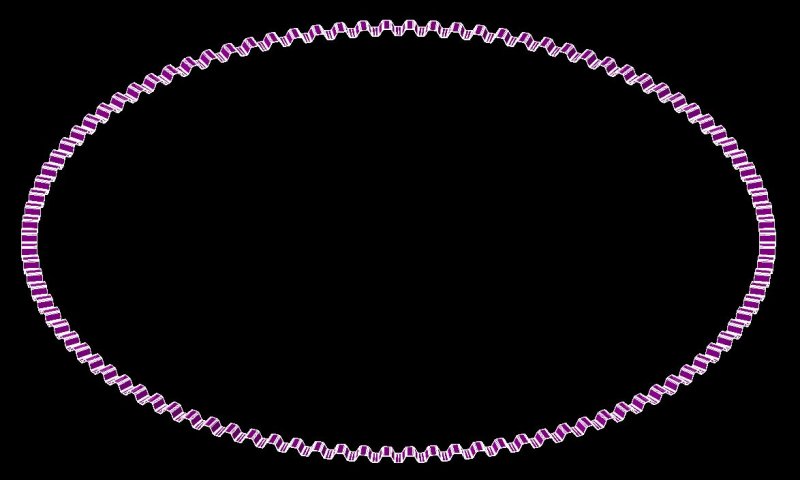

ReMark Posted November 22, 2017 Posted November 22, 2017 This is what I came up with on my second try. I used a radius of 5.96831. The extruded profile had a width of .375 and a height of .135. The number of items in my polar array was 100. It is not perfect however as there is a tapered overlap of 0.0158 at the inside circumference of the spacer. But....once the array is exploded (since it is a block) I could simply union all 100 objects and the overlap would disappear. Quote

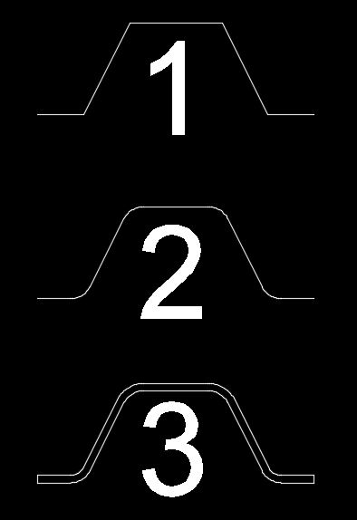

ReMark Posted November 22, 2017 Posted November 22, 2017 First you have to create your profile. Have you done that? Here is what my profile progression looked like. All three profiles are comprised of polylines. The last profile is a single continuous polyline. What do you have for dimensional data? What is the ring O.D. and I.D.? What is the height of the spacer? How many ridges are there? What is the material thickness? Quote
ReMark Posted November 22, 2017 Posted November 22, 2017 It just dawned on me why I had the overlapping extruded profiles. I forgot to taper my extruded profile. Duh! Quote

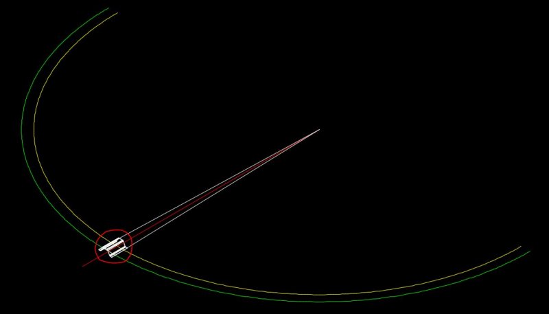

ReMark Posted November 22, 2017 Posted November 22, 2017 After you have created your profile extrude it such that it extends beyond both the O.D. and I.D. of the ring (which you should have drawn already). In the image below the green, yellow and white lines will be extruded so they extend through the profile. The extruded lines will become surfaces. These surfaces can be used to trim our extruded profile. For this you need to use the SLICE command with the Surface option. My extruded profile is circled in red. See how in extends beyond both the green and yellow arcs? A close up of the extruded profile and lines to be used to slice it. The lines on the side will give it the required taper. Note: First slice the object with the extruded arcs. Once you have the extruded profile in the shape it needs to be use the ARRAY command with the Polar option to create a full spacer ring. Quote

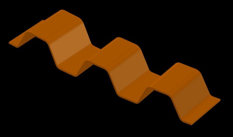

ReMark Posted November 22, 2017 Posted November 22, 2017 Lastly, here is a closeup view of a portion of the spacer. Good luck with your oil ring spacer. Have fun and post an image of the finished 3D model when you are done. Quote

BIGAL Posted November 24, 2017 Posted November 24, 2017 (edited) I am sure Remark will add more detail, you draw your profile say in same plane as the two circles add a line from outer circle to centre, place your profile at this intersection point, move it inwards a bit. Using rotate3D you rotate the profile 90degrees using say the Y option and 90. (Profile is on left side) type -vpoint 1,1,1 and you should see your profile standing up, use extrude as posted by Remark extending past the outer circle. Follow the steps above. It sounds like you should practice some of the basic commands extrude subtract union push/pull rotate3D and importantly setting UCS,s . Sent from iPad so no pretty pictures. Edited November 28, 2017 by BIGAL Quote

ReMark Posted November 25, 2017 Posted November 25, 2017 Extrude the profile using the Extrude command. It has to be extruded enough such that it will extend beyond both the O.D. and I.D. of the ring. To achieve this move the profile slightly outside of the O.D. then extrude inward. Quote

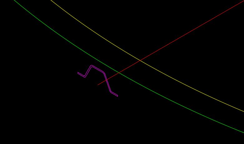

ReMark Posted November 27, 2017 Posted November 27, 2017 Profile located relative to O.D. of spacer. Profile is magenta colored. The O.D. is color green; I.D. is color yellow. The red line is used as a reference point and is drawn from the center of the circles through a quadrant point and then beyond it by a distance of 0.2. Quote

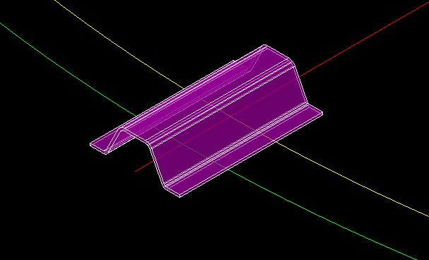

ReMark Posted November 27, 2017 Posted November 27, 2017 Profile is extruded such that it extends beyond the I.D. For reference the distance between the O.D. and I.D. is 0.2 and I extruded the profile an additional 0.2 for an overall length of 0.6. Quote
