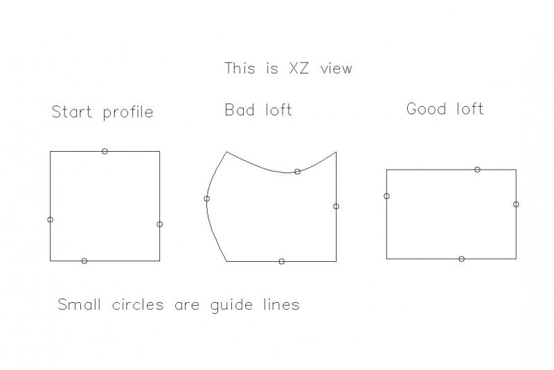

nasoox Posted November 21, 2017 Posted November 21, 2017 (edited) How to loft two or one profile with guide lines with this rules: -Loft will follow 4 guide lines, one guide conect left side of one profile to the left side etc. with one guide per side. -Guide lines don't need to connect profiles at same spots but need to connect them at same sides. -Edited : Loft will not make 'bumps' but will stretch profile so horizontal lines from profile will stay horizontal and vertical will stay vertical. What command or software can doo that? (Vanila Auto CAD, Civil, Electical, Microsoft paint, doesnt matter what software) Thank you Drawing1.dwg Edited November 24, 2017 by nasoox Quote
ReMark Posted November 21, 2017 Posted November 21, 2017 What are you trying to create that requires the three criteria you have set forth for your "perfect" Loft command? Quote
nasoox Posted November 21, 2017 Author Posted November 21, 2017 (edited) What are you trying to create that requires the three criteria you have set forth for your "perfect" Loft command? Its a 3d representation of underground tunnel (like tunel for traffic) from survey points for walls, roof and floor. It have constant shape , but different width, height and orientation, i need to stretch profile (not scale, sry, error) to touch and follow gude lines. I edited main question and I make one sketch of what I need. Edited November 21, 2017 by nasoox Quote

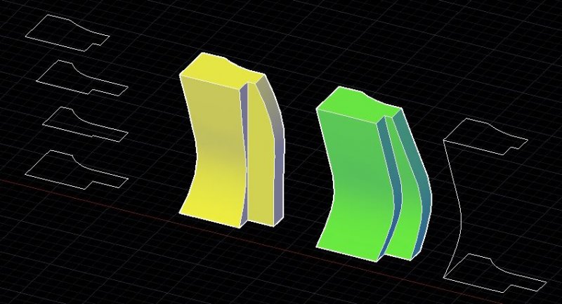

lrm Posted November 22, 2017 Posted November 22, 2017 Create one master profile for the first section. Make copies of it at the end of the tunnel and anywhere else you want. Create a guide if necessary (e.g., if you only have a start and end profile). Modify the copied profile as necessary without changing the basic topology of the shape. By modifying a copy of the master profile you are assured that the shape will loft "nicely". The yellow shape was created with AutoCAD loft between 4 profiles. The green with two profiles and a guide. Quote

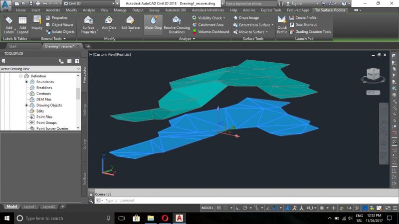

BIGAL Posted November 24, 2017 Posted November 24, 2017 Doing a tunnel this may be one approach you can string all the survey points along the tunnel based on xyz and a code for each string like leftfloor rightfloor. You can create surfaces of the tunnel from Civ3d or similar tubes are not directly supported so make maybe 2-3 surfaces bottom top etc. cross sections could be cut then. Making 3dfaces is feasible but I am sure there will be something already out there. But the other way would be to treat the points as a cloud data set and see how Civ3d handles the tube. No cad at moment. Quote
nasoox Posted November 26, 2017 Author Posted November 26, 2017 You helped me a lot, I created two TIN surfaces from points for top and bottom with boundary from wall points! And froms surface tools I used extract solids from surfaces, its not automated but its so much easier than drawing bunch of profiles. BTW: what requires more PC power, surfaces or solids? This is just small portion of map, real one is really huge (about 20Mb of points, lines and text) Quote
