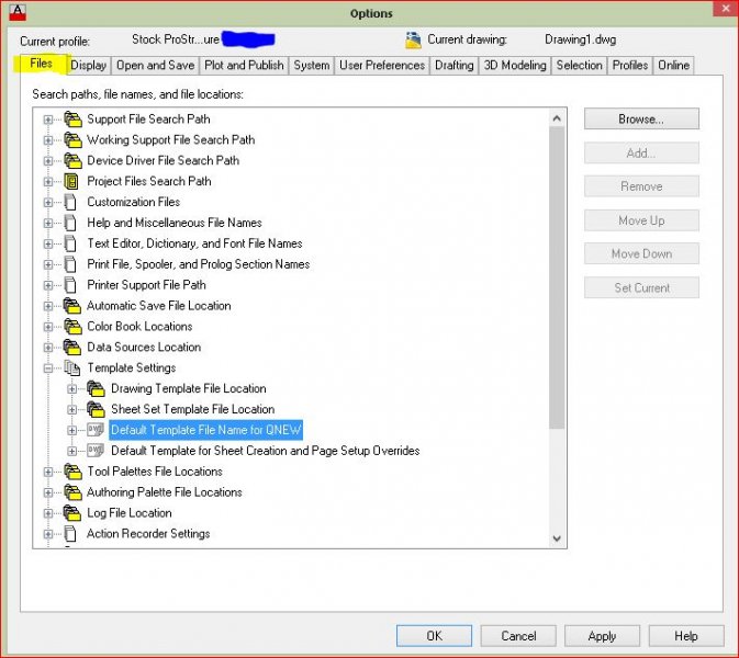

Go into OPTIONS, look at the screenshot, and redefine your Default QNew template. Just BROWSE to whichever of the ones ending in ISO, suits your needs.
Be sure to confirm your selection by clicking on OK once you have chosen one.
The screenshot is from 2013, but yours will look essentially the same.
You should do a search for the -dwgunits command, as it will prove very helpful down the road.
If you typically work in Metric, be sure to start with a Metric (ISO) template.

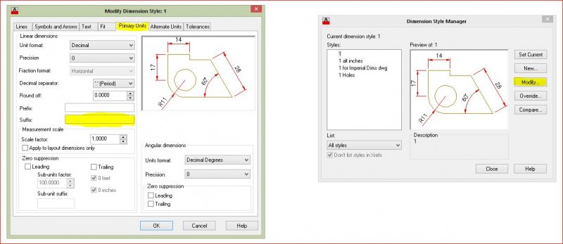

You can specify that a SUFFIX be added to your dimensions in the DIMSTYLE Manager, on the Primary Units tab, as shown in the screenshot.
I don't do Civil, there may be a more appropriate ISO template than the one you selected, as you want to default to meters.
Lots of people on the forum who will know about that though.
