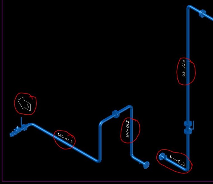

"Adding text in the model space won't allow it to be read since it’s a 3d object..."
You're saying that this (see below) is impossible?
A portion of a 3D piping run model with include text and north arrow (circled in red). The magenta lines you see at the edges of the image are the layout viewport.
The visual style used above was Realistic but even if I changed it to Hidden the text would still show up.

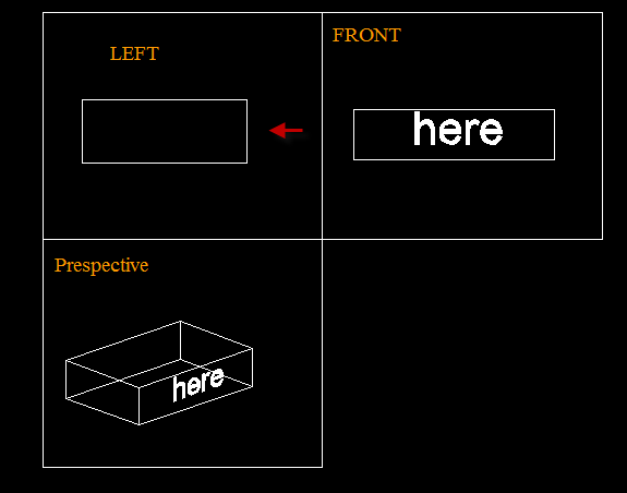

Hi
Ive attached a screenshot
I think I want the text to always face the camera.
The text should always be read whatever viewport I set it.
Please don't tell me you are expecting to see the text in the viewport labeled "LEFT".
that is the problem...i came from 2d world :)
how can i see the text in all viewports? how to do it right?
Place text on that side as well. One text can't be read from all angles. Can you view your monitor from the side?

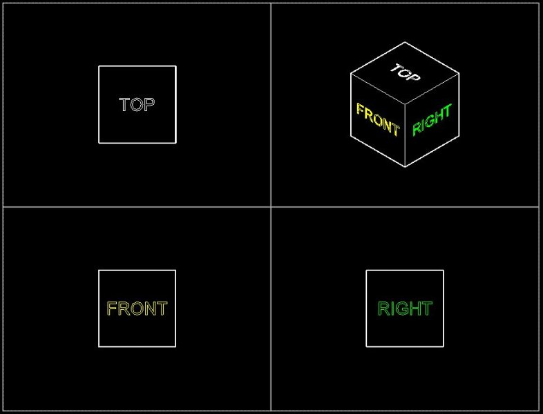

Example of a 3D cube with text on all faces. Visual style: Hidden.
