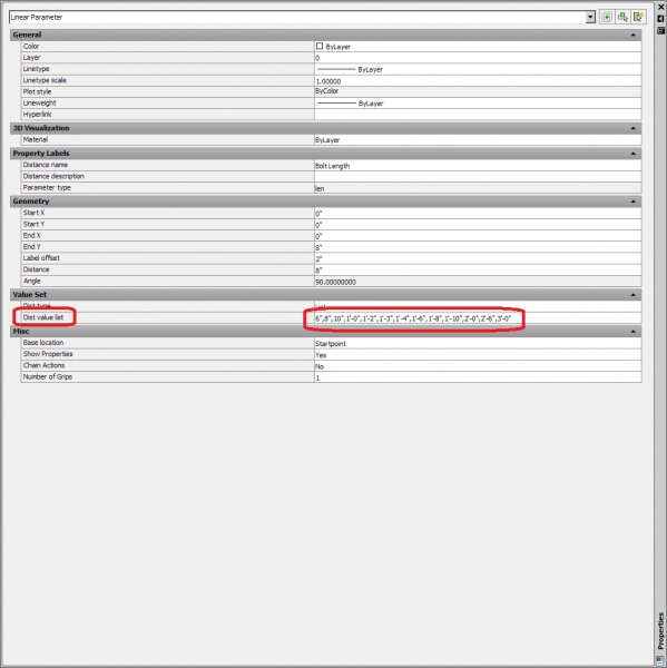

SLW210 Posted November 14, 2017 Share Posted November 14, 2017 I guess this is a dynamic block? If so go to block editor and select the relevant parameter, then Properties and adjust the values. If that's not it, post your block. Quote Link to comment Share on other sites More sharing options...
Thando Posted November 15, 2017 Author Share Posted November 15, 2017 Wonderful, that's all I 've done. I'll be submitting my Assignment this week. So helpful Quote Link to comment Share on other sites More sharing options...
