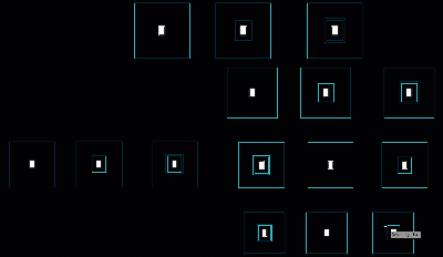

Can some one help? need Diagonal Lines by selecting all and draw Diagonal lines in between outer rectangle to inner maximum size rectangle.
Thank you.

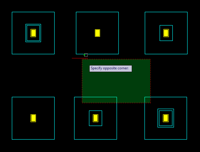

Hi,
Be sure to have the external rectangles visible in the screen and just select the external rectangles as the message of the program indicates to:

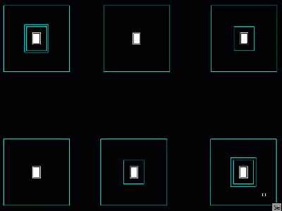

if different size of outer rectangles not getting diagonal lines. please fix to work any size outer rectangles.
Thank you...

Post an example drawing. We'd need to define an area rule of what is considered an 'outer' rectangle.
Actually try this:

hi ronjonp,
it is working. thank you for updating code and advice.
Glad to help. BTW .. why don't you create blocks for these?
