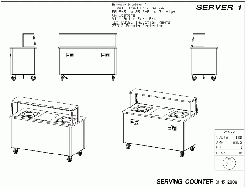

stevsmith Posted January 15, 2009 Posted January 15, 2009 Hello. Is it possible to create a lisp routine that will take a 3d model, Flatshot it from 4 views, e.g plan, front, left and right. then open a new drawing and insert the blocks @ 0,0 on a 1st angle projection. I know that some of the guys in here like a challenge. I'm not lisp litterate. Thanks. Quote
Lee Mac Posted January 15, 2009 Posted January 15, 2009 Would probably have to be a VBA routine, as LISP would only work in the current drawing and the routine would stop when a new drawing is opened. Quote

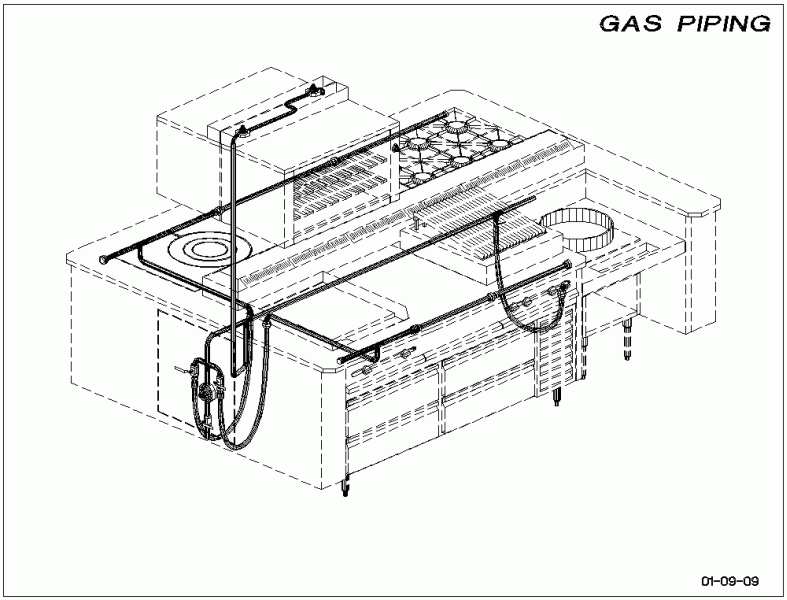

David Bethel Posted January 15, 2009 Posted January 15, 2009 I do similar things all of the time. But I use DXB plotting for isometrics and elevation. Plan views are on another page. And it is a very complex operation. -David Quote
rocheey Posted January 15, 2009 Posted January 15, 2009 I do similar things all of the time. But I use DXB plotting for isometrics and elevation. Plan views are on another page. And it is a very complex operation. -David Im assuming you tried the SectionPlane/GenerateSectionGeometry call? Ive revived an old project where Im attempting to generate both hidden line elevations, and hatched/hidden line sections. I cant seem to find any singular tool that will be able to do much of what Im wanting Quote
David Bethel Posted January 15, 2009 Posted January 15, 2009 rocheey, No, this is all done in AutoCAD R12 DOS on a Win98 Machine. This is a combination hidden line / continuous line of a gas piping schematic we do regularly. -David Quote
