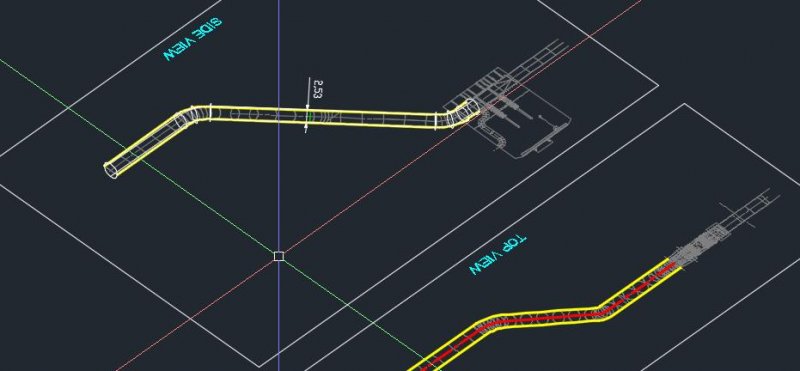

Saqib_theleo Posted November 5, 2017 Posted November 5, 2017 Hello everyone, I can make simple 3d objects but I don't know how to make 3d pipe as showing in this drawing. Simple 3d pipe is simple by making a circle and sweep it around the Poly line, but if someone can guide me how can I make this kind of 3d pipe I'll be thankful. Thanks. 3d Pipe.dwg Quote

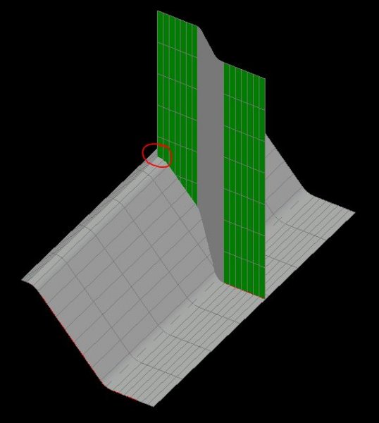

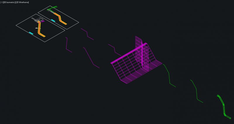

SEANT Posted November 5, 2017 Posted November 5, 2017 This illustrates a step by step method to get the compound bend pipe run. I assumed the elbow radius to be 5 at all bends. 3d Pipe_bySteps.dwg Quote
Saqib_theleo Posted November 5, 2017 Author Posted November 5, 2017 (edited) Hi SEANT, Thanks for your help, I tried to follow these steps you used, Step 1 to 3 are easy but after Surface Extrusion I could not get the Intersecting Line (required 3d path) by Intersect command. Can you please tell how did you do that and did you use radius command after getting 3D path. Hi Bigal, Yes making 3d pipe is simple but I was looking for the 3d path from these two lines. Thanks. Edited November 5, 2017 by Saqib_theleo Quote
ReMark Posted November 5, 2017 Posted November 5, 2017 (edited) Check your drawing and make sure the extruded surfaces actually intersect with each other prior to invoking the command. My guess is your extrusion of the top view is in the wrong direction. Why is the overall length of the pipe (end to end) different in the two views? The length in the top view is shorter than the length in the side view. Edited November 5, 2017 by ReMark Quote
SEANT Posted November 5, 2017 Posted November 5, 2017 I used AutoCAD 2016 for the intersection - I'm not sure if AutoCAD 2010's Intersect command is compatible with Surfaces. And yes, I did reorient the UCS to create the fillets. Each individual path was then used to sweep a solid. Quote
Saqib_theleo Posted November 5, 2017 Author Posted November 5, 2017 Hi ReMark, yes length is little shorter I didn't notice but not big problem, I just wanted to learn the procedure to make it this way and my extruded surfaces are intersecting with each other. Thanks. Quote
Saqib_theleo Posted November 5, 2017 Author Posted November 5, 2017 Hi SEANT, ok but right now am using laptop where CAD2007 is installed. I'll try this with some later version and one last thing did you use 3 point UCS to reorient the UCS.Thanks. Quote
SEANT Posted November 5, 2017 Posted November 5, 2017 . . . . did you use 3 point UCS to reorient the UCS . . . . Indeed, I did. Quote
