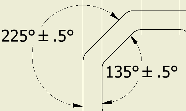

I've got a customer who has drawn a 45° angle as 225°
I don't know why, but I wanted to draw it that way to please them.
I can't figure out how to do it.
Any suggestions?
Inventor 2017
I'm sure you know how to draw a line at 225 degrees. Is the problem more to do with calling it out as such using the dimensioning capabilities of Inventor?
Yes, I'd like to use Inventor Dimension tool.
Sorry, I am not familiar with it. Is there an option to designate in which direction 0 degrees should be and what direction angles should be turned?

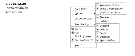

After you select the Dimensioning Tool are there any right-click options?
Oh good idea.
Right Click Opposite Angle gives me 225° Angle, I just have to figure out how to place it.
I got you this far...the rest is up to you. Good luck.
