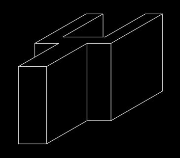

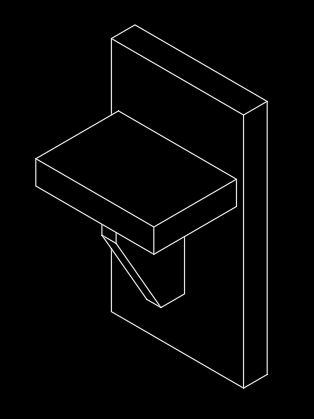

Isometric view of support bracket.
Oblique view of connecting piece. I used an angle of 30 degrees and the depth was shortened to 3/4 of the length shown in the diagram. I could have used an angle of 45 degrees and cut the depth to 1/2 of the length shown or any combination of the two angles and depth. Did your instructor suggest an angle and depth ratio to use?
