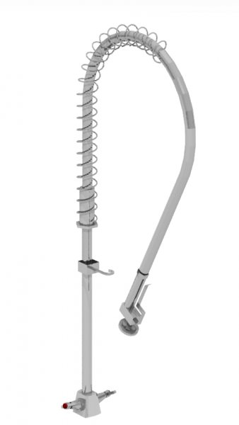

chokri Posted October 24, 2017 Posted October 24, 2017 hi guys, I need help, how can I make the spiral follow a path to make something like this : please help me Quote

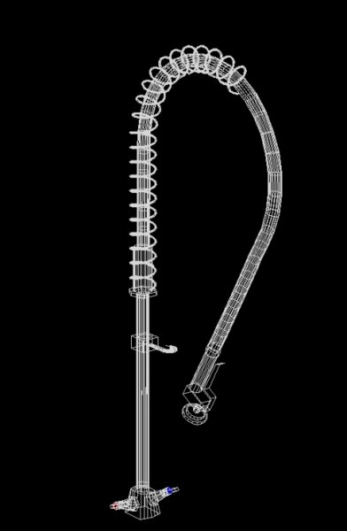

David Bethel Posted October 24, 2017 Posted October 24, 2017 I'll be honest. I cheat. Each segment of the spring is a individual mesh that has been extruded along a path. From a distance it looks real enough ( for me ) I have no clue as to how to do it with 3DSOLIDs -David Quote
chokri Posted October 24, 2017 Author Posted October 24, 2017 Thanks for your comment, can you tell me how did you do that in steps? I will be so grateful Quote
Cad64 Posted October 25, 2017 Posted October 25, 2017 I haven't tried it myself, but take a look at the lisp routine in this thread: http://www.cadtutor.net/forum/showthread.php?89044-Helix-Along-a-Path Quote
SLW210 Posted October 25, 2017 Posted October 25, 2017 I have used that LISP, it works pretty good. The command to run it is HELIX2. I just browse to my LISP folder and drag & drop it in the drawing to use it. If you need it more than occasionally you can look into THIS. Quote
