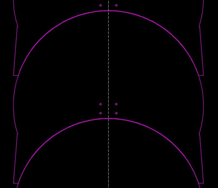

trying to draw something using path array.
I've attached part of the drawing. I want the objects to have a 2mm space between them.
any how or info on how to do this would be hugely greatful
Drawing1.dwg

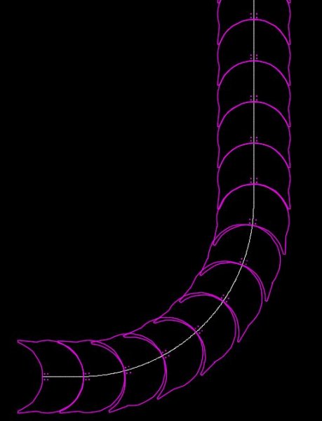

I would recommend that you first move the line segment into the proper position. Next I would use the PEDIT or JOIN command to make your lines and arcs (I think there is even a single lightweight polyline too) into one continuous polyline. Reposition the car top relative to the beginning of the line and invoke the ARRAY command.
Here's what I was able to accomplish. For the sake of clarity I made the path layer white and the car_top layer magenta. Having both objects the same dark color just doesn't work for me.
Top down view in 2Dwireframe visual style.
A portion of the array along the path.

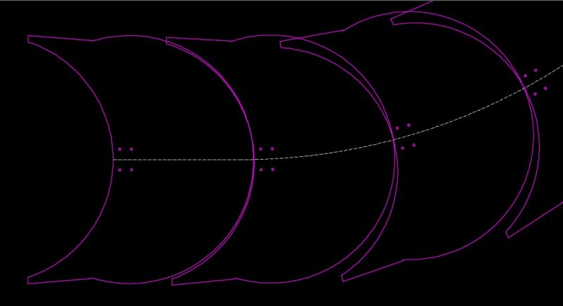

Closeup of array in a straight segment of the path.
Closeup of array at beginning of path. See what is happening with the corners of the "car_top" as it makes the turn?
Thanks for the input ReMark. I see what you mean by the corners.
This is a segment of a piece of machinery I seen. It's a carousel, which is a loop around a warehouse.
If I move the base point, would it prevent the corners overlapping?
I think the separation distance is too small. You specified 2mm.
