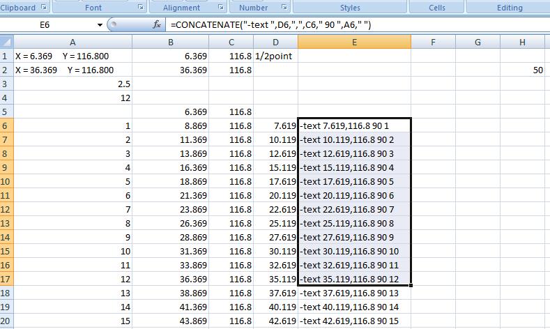

OK here's a simple example it just uses the row numbers to drop incrementing numbers into a drawing. To use excel this way all you need do is highlight the cells colored yellow and press Ctrl+c (copy to clipboard).
In Autocad click inside the command line, the cursor has to be active in the command line or it will paste as an ole object in the drawing, so click twice inside the command until the cursor is active then paste Ctrl+v from the clipboard, thats it.
This example places 10 numbers in the drawing at x=0 and y= 10 up to 100

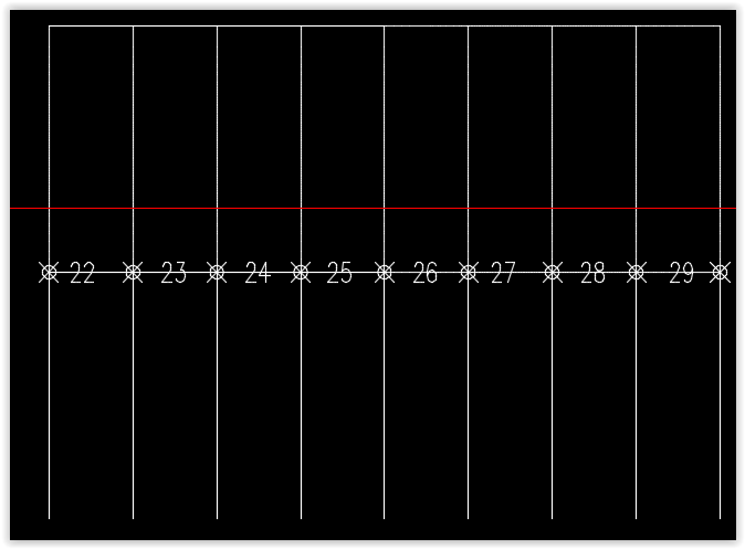

Using Autocad easy if car park bays are straight pick 1st bay line, pick last bay line, enter start number if not nil, text is placed based on the number of lines crossed and half way between each line. I dont have code yet but big hint is ssget "F". I know it works based on something else I have done.

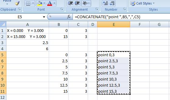

Copy and paste 1st point x y and last point x y to Excel how many bays and use VBA inside Excel to write a script, Steven-g as you have suggested previously its possible to do lots of calcs in excel and just copy the last column created to the command line. When we draw car parks they have set width so with two pts you can work out all the other points.

Thats what I tried to show in my own clumsy way with that excel file previously, it just uses the row number of excel and performs a calculation on that numer then uses the result to make the script/list.
You can do exactly the same with just a few coordinates from Autocad and then as you suggest divide the results by 50 to locate each parking bay.

bjenk8100 think of it like this you have LT open and use ID and pick a pt paste to excel look at image, I would use a VBA macro to automate some of the steps. I just copied the highlighted cells to the command line more calculations can be done.
I had a few minutes and checked a real dwg. Bjenk8100 now I have made the spreadsheet I can do as many as I like, The spreadsheet can be vastly improved to take into account an angular answer, using ucs would probably get around it. I appreciate what you posted but where in amongst the 165 answers is one that matches the original request.
No VBA NO macro's just pure Excel.
