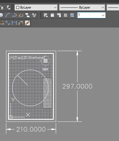

BIGAL Posted October 10, 2017 Share Posted October 10, 2017 Here is you M mm dwg layout set up for an A4 sheet, note the Viewports toolbar and in particular look at the value I have typed in which is 1 this means scale at 1:1000 automatically. Your layout was way to small, note the real size of the outer box, this is actual sheet size but you must be inside this paper size so I used an offset of 10 to make the inner MVIEW, clicked inside looked at the number in the Viewport toobar and it was 0.98543 so I typed 1 to make it an exact scale, could have type 2 or 0.5 again an exact metric scale. Because its an A4 sheet I plot at a 1:1 scale as the mview has done the scaling for me. Lastly like the others reset your units if working in mm then layout would be the same but again for 150 circle a 1:1 mview scale. Quote Link to comment Share on other sites More sharing options...

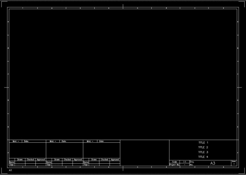

ReMark Posted October 10, 2017 Share Posted October 10, 2017 (edited) You did not exactly answer my question. So, you are using Civil 3D to draw a piece of hardware. What hardware? Is it something that might be used by a machinist? If you had started out using the correct drawing template file you would automatically be drawing in millimeters. That template file is named acadiso.dwt and it should be listed along with two other metric based template files. One is set up for architectural drawings and is named Tutorial-mArch.dwt while the other is set up for manufacturing drawings and is named Tutorial-mMfg.dwt. You do NOT have to recreate everything from scratch every time you start a new drawing. You instead use a drawing template file (AutoCAD default, one of your own design, or one borrowed from another CAD user). Your instructor should have covered what a template file is and how one goes about creating a custom one. Forum member Nukecad has generously created several different sizes of metric based template files free for the download. I'll see if I can find and post a link to it. Here you go..... http://www.cadtutor.net/forum/showthread.php?99585-titleblock&p=677649#post677649 Scroll down to post number 6 in the thread above to find METRIC-TEMPLATES.zip. Re: Dimension styles. They can be accessed via the DDIM command as one option. You can use or modify the Standard style or create one entirely to your specifications assuming you know beforehand what you want. Where are you located? Edited October 10, 2017 by ReMark Quote Link to comment Share on other sites More sharing options...
ReMark Posted October 10, 2017 Share Posted October 10, 2017 Here is a sample image of Nukecad's A3 drawing template file. Be aware that the title block utilizes attributes. I doubt your instructor has covered that topic yet. Quote Link to comment Share on other sites More sharing options...
