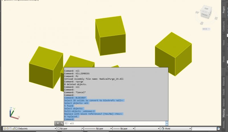

JamesBorubar Posted October 8, 2017 Author Posted October 8, 2017 I think he wants to replace existing solid models with block instances. For example, if he has 100 individual nuts, washers & bolts in his model, he wants to automatically replace all those individual parts with block instances. I don't know how to do that without the aid of a custom lisp routine, but even then, I think it would be quite difficult to precisely replace the solids with block instances, taking into account the exact position, rotation and alignment of each solid. This is why it's important to have a game plan before you start building a model. If you know you're going to have repetitive items, like nuts & bolts, create blocks in the beginning. Trying to go back now and replace everything with blocks is going to be a chore and something you will probably have to do manually. I am looking for tool similar to that: http://www.cadforum.cz/cadforum_en/simplifying-3d-drawings-by-replacing-repeating-3d-solids-blocks-tip10802 but without restrictions. I've got ready 3d model with 3d solids. Quote

JamesBorubar Posted October 8, 2017 Author Posted October 8, 2017 And how does that routine restrict you? The application doesn't support combined 3D solids (3DSolid) created e.g. using boolean operations, only boxes, cylinders and other primitives. Quote
halam Posted October 8, 2017 Posted October 8, 2017 I am looking for tool similar to that: http://www.cadforum.cz/cadforum_en/simplifying-3d-drawings-by-replacing-repeating-3d-solids-blocks-tip10802but without restrictions. I've got ready 3d model with 3d solids. Intressting routine, but i could not get it to work. modelled 5 cubes all 1.0 m3 but is doesn't seem to work. How does this routine work? What does it calculate to check for equility? (i was thinking : volume and boundingbox?) Quote
JamesBorubar Posted October 9, 2017 Author Posted October 9, 2017 Intressting routine, but i could not get it to work.modelled 5 cubes all 1.0 m3 but is doesn't seem to work. How does this routine work? What does it calculate to check for equility? (i was thinking : volume and boundingbox?) It works, but only with sample drawing Kvadry.DWG ... Quote

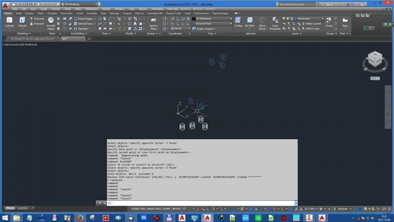

JamesBorubar Posted October 9, 2017 Author Posted October 9, 2017 It works, but only with sample drawing Kvadry.DWG ... Sorry I was wrong, it works with AutoCad 2015: Quote
