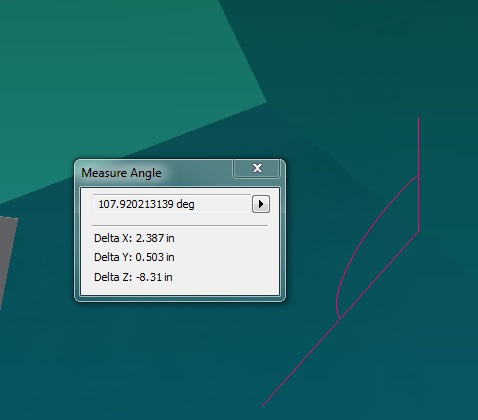

First, I modeled the solid pyramid (as attached previously). Then I used Inventor to tell me the angle (all precision/decimals) from one face to the adjacent face, about 107 deg:

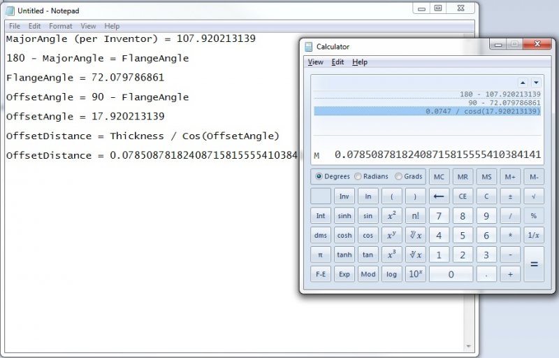

This angle is subracted from 180 to get the FlangeAngle, about 72 (OffsetAngle). That is about 18 deg. The sheet metal Thickness divided by the Cosine of that angle gives the OffsetDistance for Thicken/Offset, about 0.0785 inches:

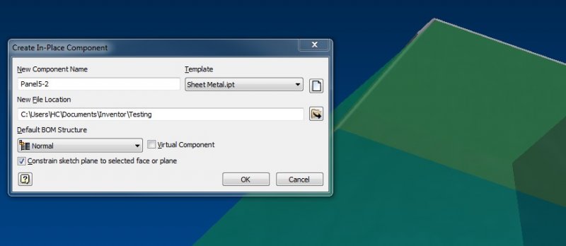

With the pyramid in a new Assembly, I hit Create Part and selected a Sheet Metal part template:

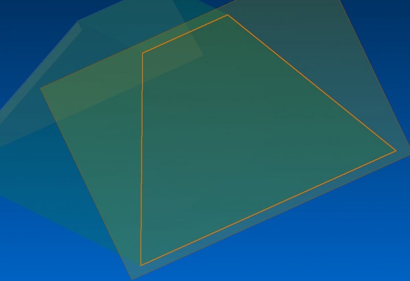

I then clicked on one of the faces of the triangle, then Start 2D Sketch, then clicked on the same face of the triangle, then Project Geometry and then clicked on the entire face:

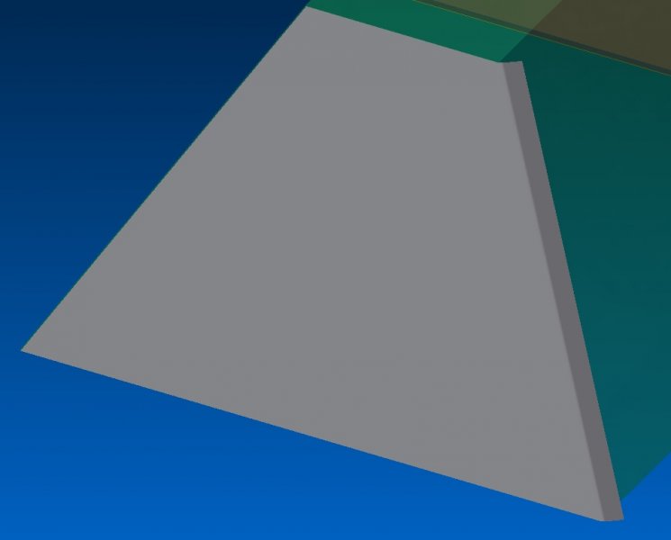

After hitting Finish, I created a Face from the sketch. The next steps were fairly easy (I arbitrarily decided to put the flange on the right side of the panel): I Offset the left side of the panel to allow clearance for the bend of the flange from the adjoining piece (when all panels were put in place in the Assembly), and I Thicken(ed) the right side to allow the flange to reach beyond the adjoining panel on that side. Both Offset and Thicken commands were done using the OffsetDistance shown in the screenshots above. I then added the Flange and used the shown FlangeAngle as the angle.

I used AutoCAD to draw the joint in 2D to figure out how to measure the OffsetDistance (which is where I saw that I had this angle and that measurement and used CAD (Cosine = Adjacent / Distance) to arrive at the OffsetDistance (FYI). I'd love it if someone could tell me how I could have measured that distance with Inventor and some mouse clicks (although, now that I know how to calculate it, it's kind of moot).
