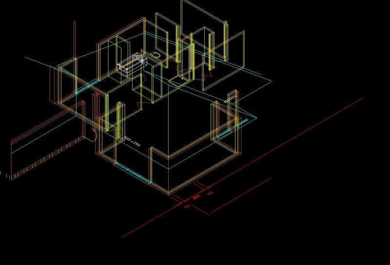

BIGAL Posted October 7, 2017 Share Posted October 7, 2017 You need to look at 2.5D in that your elevations are drawn in 3d, LT supports 3d line work so it can be done. Check out "Thickness" in particular Quote Link to comment Share on other sites More sharing options...
