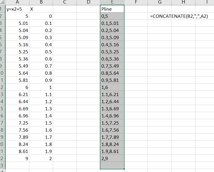

Another trick is put the formula into excel and calcaulate x & y values then use excel to join the x plus , plus y X,Y then in autocad do PLINE just cut & paste the x,y values from excel to the autocad command line parabola will appear.

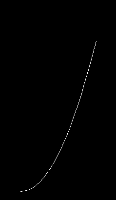

hi, i tried that, it did draw a line but the starting point is way off, nowhere near where I wanted...can you mention a solution? Thanks
See my post here.  Since a parabola can be represented as a 2nd order polynomial it can be defined with just 3 spline control vertices.
Edited by lrm
Have a look at this I copied column E to command line press enter to end.
