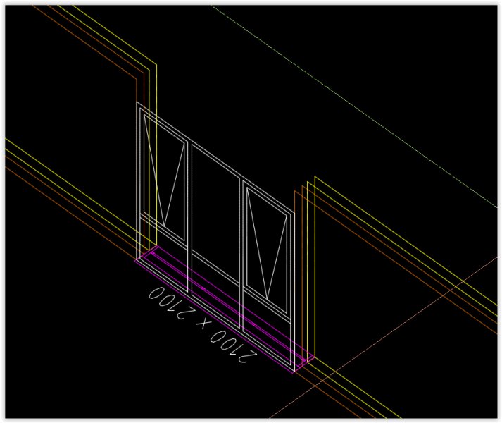

If you have the right software you can do like this.
I appreciate the input guys! Typically the window type I'm considering this for is a typical Victorian townhouse with timber sash windows. I'd give more info but that'll have to wait as I'm swamped today and tomorrow.
BKT, I'd like the option to choose the distance between rows/columns separately if possible, as they are occasionally different. And I mean distance between the panes.
BIGAL, this looks like it's headed in the right direction. We only work in 2D though, unfortunately. Also we dont work with architectural indications like the arrow you have on the window... We basically create a line drawing elevation for 99% of our elevations usually from 'tracing' over 3D scanned ortho-photos.
Again, your input is much appreciated!
