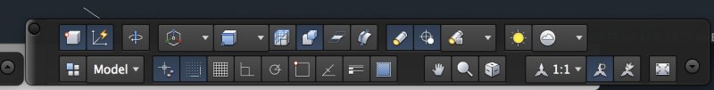

Where do I find this DYN? this is my status bar, shown everything that is turned ON and OFF
Thank you for everyone helping me out
Sorry, I have my buttons set to display as text. I don't like icons. Your icons look very different from mine though, so I don't know which button toggles dynamic input. I'm surprised to see the 2015 interface looks so much different than 2014.
You can use the F12 key on your keyboard to toggle Dynamic Input on and off.
