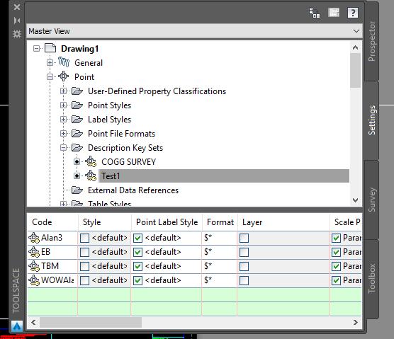

I have posted here in lisp as its a programming question not generic CIV3D.
I am trying to get into the Description key sets so I can change layer names, we are looking at a new way of processing data. Getting into CIV3D styles etc is about knowing where to look and I have done a fair bit of googling trying to find the direction up the CIV3D tree but this one I can not seem to find. It can be as easy as using the correct property name.
A bit more testing almost there starting to get at properties now.
Version 6 05 November 2017
; this is the 1st step in importing or changing description key sets in bulk
; Takes advantage of say using excel to make a csv file.
; Hard coded for file at this stage
; 1st line holds key type details must match this
; Name,Pointstyle,PointLabelStyle,Format,Layer,ScaleParameter,FixedScaleFactor,Usedrawingscale,Apply to X-Y,Apply to Z,RotationParameter,FixedRotation,RotationParameter,FixedLabelRotation,ClockwiseRotation

(defun read-keyset ( / fo )
(setq fo (open (getfiled "Select a csv File" "c:/alan/lisp/" "csv" 4) "r"))
(setq lst '())
(while
(setq keyvals (read-line fo))
(setq lst (cons (_csv->lst keyvals) lst))
(princ "\n")(princ keyvals)
(setq lst (reverse lst))
(close fo)
;  search for known key set
(defun get-addkeyset ( / )
(if (not ah:vercheck)(load "vercheck"))
(ah:vercheck)
(if (not ah:Getvals)(load "Getvals"))
(AH:GETVAL1 "Enter new or old key set name"  25 20)
(setq pdks (vlax-get-property *AeccDoc* 'pointdescriptionkeysets))
(setq ptstys (vlax-get-property *AeccDoc* 'PointStyles))
(setq ptlabstys (vlax-get-property *AeccDoc* 'PointLabelStyles))
(vlax-for keyset pdks
(if (= (vla-get-name keyset) VAL1)
(setq foundkeys KEYSET)
(setq foundkeys (vla-add pdks val1))

; put test stuff here
(defun dummy ()
; pointstyle stuff
(vlax-for keysinset foundkeys
(setq ps   keysinset)
(setq ptsy (vlax-get-property ps 'pointstyle))
(setq name (vla-get-name ptsy)) ; use this to match
(vlax-put-property ptsy 'Name "001")  ; not working need a solution

Adds a new key name but blank entries
Adds codes to new keyset
Up dates an item based on code name and description eg layer new or existing key set
Renames key description
In progress is a full upload of as many keys as you want including all 15 variables from a csv.

Well I am getting there and pretty close to finishing the defuns to do stuff I am having a little problem each description key has a Labelstyle which is a seperate set of style again like the description key sets. Civ3d is so intertwined.
I need some help there are 2 items I can not seem to change out of the 14 that make a key record.
I can dump a description key

I need to change the "Name" to a known label style name I know its part of the property to do this but I am stuck.
Hope this makes sense unfortunately you need CIV3d to see the label styles.
