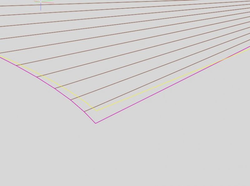

I have a series of 3DFaces provided by the project civil engineer - these elements represent footpaths, roads, cycleways etc. These elements are sloping on various grades as one would expect. I'd like to generate a 3D Polyline that forms a boundary around all the elements that form a section of road or footpath. I can use the 3DPoly tool to visit each external vertex and snap to the vertex but is there a tool or Lisp program that can do this automatically? I've tried the LineworkShrinkWrap command but that doesn't retain all the correct Z values for the external vertices.
In the attachment, the layer DESIRED RESULT (magenta) is what I am trying to achieve.

I've updated the CAD example to fully illustrate the problem
original 3d faces (CYCLEWAY layer - brown)
lineworkshrinkwrap (LINEWORKSHRINKWRAP layer - yellow)
desired result (DESIRED RESULT layer - magenta)
The desired result was manually created by tracing the extent of the 3DFaces using 3DPOLY command.
Hopefully this makes more sense?

I am confused the magenta and yellow are the same.
Using shrinkwrap in CIV3D outputs a 3dpoly what you want.
Your profile says Revit is this correct ?

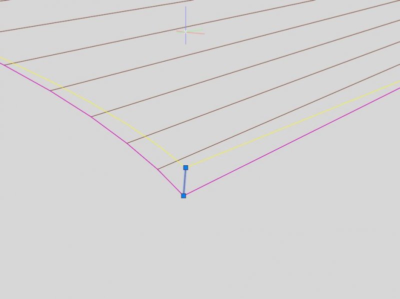

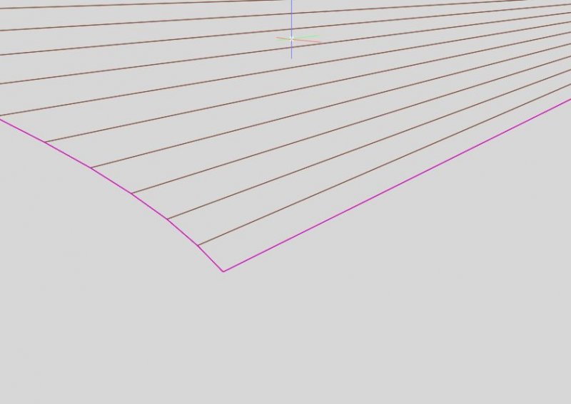

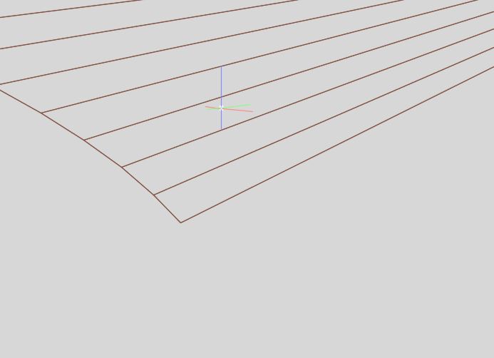

Bigal, thanks for your reply. I have to disagree. LINEWORKSHRINKWRAP in Civil3D doesn't do what I want. The magenta and yellow lines are different. The magenta line is what I want. I've attached some screenshots - you can see the difference between the original 3D faces, the 3D polyline (magenta) manually traced using 3DPoly and the result from running LINEWORKSHRINKWRAP in yellow.
BTW - my profile is correct - I am using Revit mostly, and this particular workflow is to allow me to create Revit Floors automatically from Civil3D elements using Dynamo.
Original 3Dfaces = brown
Manual trace with 3DPOlY = magenta
Shrinkwrap = yellow
Difference shown in the last image
