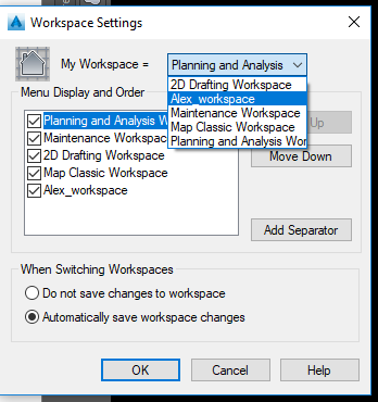

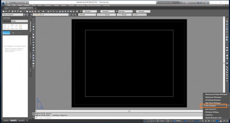

cat3appr Posted September 23, 2017 Posted September 23, 2017 Hello, Once I saved my workspace, how can I force CAD to always open up with that workspace? It's really annoying as even if I save my workspace, then CAD opens up with the ribbon. And how do I save this workspace as a file and make it available on other PCs? cheers! Alex Quote
ReMark Posted September 23, 2017 Posted September 23, 2017 It does not sound as though you actually saved your workspace. Describe the method you used to save it. Are these other PC's running the same version of AutoCAD that you are? Quote
cat3appr Posted September 23, 2017 Author Posted September 23, 2017 (edited) It does not sound as though you actually saved your workspace. Describe the method you used to save it. Are these other PC's running the same version of AutoCAD that you are? I saved the workspace as per screenshots, closed CAD, repoened and I got the ribbon again... No, other PCs I have no idea, it is for future reference, as I have to work with different machines, I'd like to save my workspace as a file. Edited September 23, 2017 by cat3appr Quote

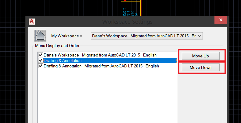

Dana W Posted September 23, 2017 Posted September 23, 2017 Command _WSSETTINGS. Or click the settings button on the task bar >> Workspace Settings. Move the one you want to be Default to the top of the list. Could it be that simple? Quote
