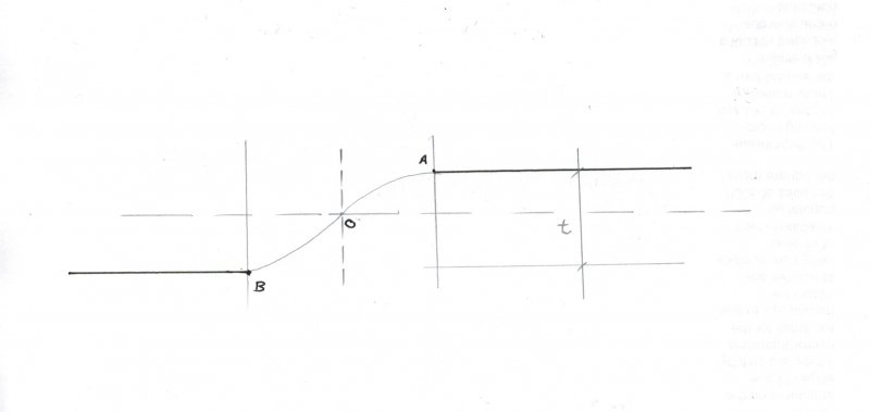

PJ01 Posted September 18, 2017 Posted September 18, 2017 (edited) Hello, I am a raw newby, and my class starts next week. Can't wait. Can anyone please advise the best way to draw an S curve AoB in the attached drawing? How do you determine the radius of the arcs AO and BO? At point B, the curve needs to be a bit more horizontal initially, like at point A. My mistake with the sketch Edited September 18, 2017 by PJ01 Quote
SEANT Posted September 18, 2017 Posted September 18, 2017 The vertical requirement, 't', is specified; is there a similar horizontal requirement? Quote

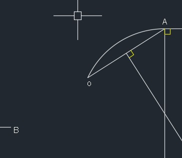

guran Posted September 18, 2017 Posted September 18, 2017 Start an arc att "A" with END at "O" and DIRECTION parallel to the horizontal lines, and then do the same from "B". You can also use the kommand BLEND. Quote
SEANT Posted September 18, 2017 Posted September 18, 2017 Ah, yes. Arc - Start, End, Direction is the way to go. Quote

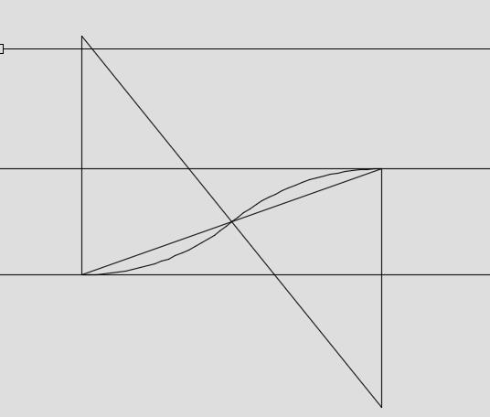

BIGAL Posted September 18, 2017 Posted September 18, 2017 This is a double reverse curve and the formula that applies is relevantly simple you have 3 variables r1 r2 and offset for parallel lines. You can do set r1 what is r2? r1=r2 etc My cheat sheet is at work. I have it on my wish list to do one day but was looking at the more complicated non parallel lines solution. Just need a starting pt, there is also what is the rad for a offset given a length the double must fit between. If you look at the diagram you can see the diagonal line intersects the circles. Quote
PJ01 Posted September 18, 2017 Author Posted September 18, 2017 Thanks kindly, for all these suggestions. Tried the Arc: Start, End, Direction command and it worked perfectly Quote

steven-g Posted September 18, 2017 Posted September 18, 2017 I would just find the centre of the arc, which is the intersection of two perpendicular lines, one perpendicular from point A the other perpendicular from the centre of line Ao Quote

BIGAL Posted September 19, 2017 Posted September 19, 2017 Some solutions R1=R2 (off^2+dist^2)/(4*off) (off^2=dist^2)/(2*off) - R1 = R2 where R1 is known AB= ( 2*off*(R1+R2) )^0.5 length of sloping line. Quote
