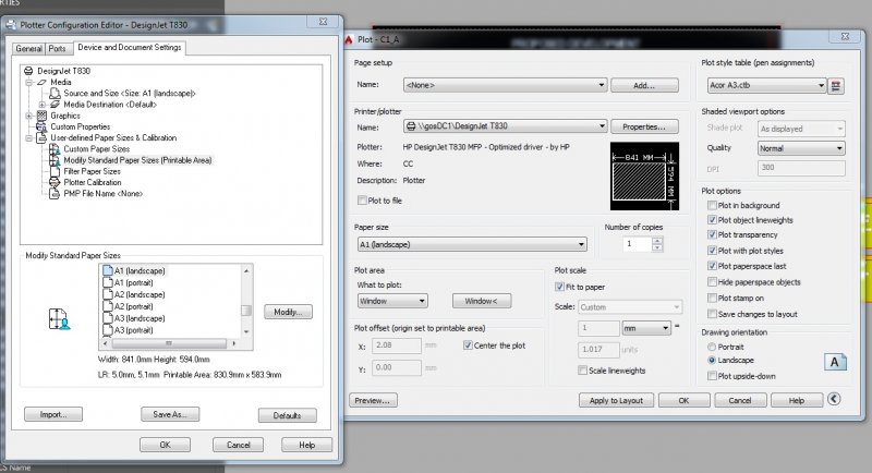

Dana W Posted September 17, 2017 Posted September 17, 2017 Can you post screen shots of both page layouts? Are you using a customized *.pc3 file for your pdf? Quote
Steve Johnstone Posted September 17, 2017 Author Posted September 17, 2017 Hi Dana No we are not using a special PC3 file Plotting problems.docx Quote
BIGAL Posted September 18, 2017 Posted September 18, 2017 Are you using a lisp or publish to send to plotter looks like a top right window problem, really want the plot dialouge to see what is set like Dana request. Quote
Steve Johnstone Posted September 18, 2017 Author Posted September 18, 2017 Hi BIGAL and Dana We are currently not using a lisp or publish. This is just a straight single page plot. Please see attached Plot config as requested. Plot config.docx Quote
BIGAL Posted September 18, 2017 Posted September 18, 2017 This says DWG to pdf is not the problem rather when you use the plotter HPXXXX. Are you just changing to it, are the other setting changing the sheet size, you can have hidden values even though its called A1 it could be the size of a stamp when plotting as that is what has been saved rather than a plot name, we have plotted 3500mmx541mm no probs just set up the sheet correct. I have a sheet called 4400x3500 for plotting jpgs at high res. Go into the printer properties in windows and in Autocad check your sheet sizes not just what they are called but actual plot area size. Ps Go advanced do screen grab and post an image no need for word and then we can see without opening. Use paste to Paint then save as JPG. Quote
SLW210 Posted September 18, 2017 Posted September 18, 2017 Yes, the paper size and/or orientation is off at the Plotter Properties or at the plotter most likely. Show the Plot settings and plotter properties for plotting to the plotter. Quote

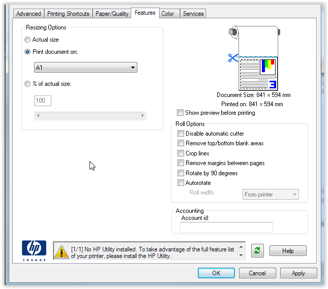

Steve Johnstone Posted September 19, 2017 Author Posted September 19, 2017 Is this the info you are looking for? I've tried using print extents and scale to fit but it didn't work. Quote

BIGAL Posted September 19, 2017 Posted September 19, 2017 Your A1 looks correct when you do the preview what do you see ? Is it the complete title block ? Also check outside Autocad from windows control panel, printers, again check the settings under properties that the A1 size is set corrrect. Is it manual or roll feed etc I can guarantee that Autocad can say one thing and Windows printer settings are different, screwing up the plots. Quote
Steve Johnstone Posted September 19, 2017 Author Posted September 19, 2017 The Print preview looks fine. I've gone into windows to check the sizing and that is fine. I've tried creating my own custom sheet in windows which is the same as an A1 then tried plotting with it but that didn't work either. Quote

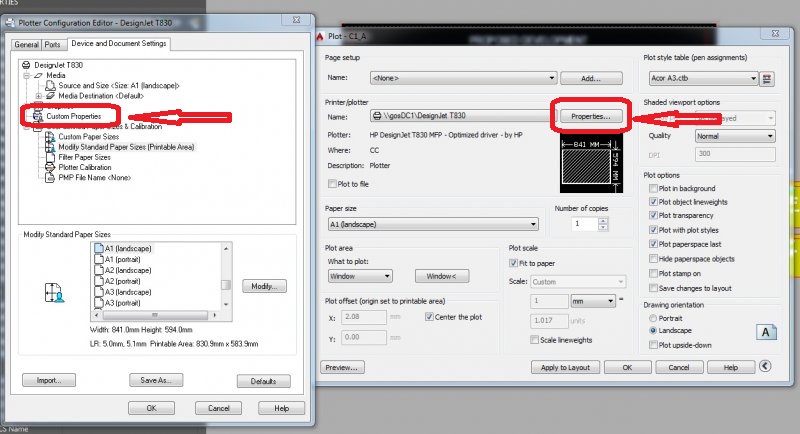

SLW210 Posted September 19, 2017 Posted September 19, 2017 You need to select the Custom Properties and see what the paper size and orientation are. Quote

SLW210 Posted September 20, 2017 Posted September 20, 2017 Can you post the Plotter Properties settings as requested? Maybe post the drawing file and someone can check it out. Generally speaking, usually, if the plot preview is correct, the problem is the plotter driver or settings at the plotter. Quote

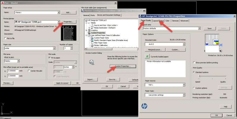

rkent Posted September 20, 2017 Posted September 20, 2017 Post screen shots of the Paper/Quality tab and Layout/Output tab. Quote
