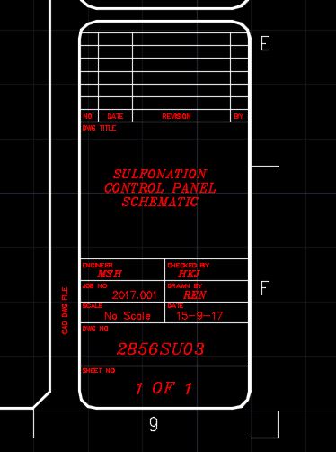

ReMark Posted September 15, 2017 Posted September 15, 2017 The template works exactly as it was designed by AutoDesk. The title block information is comprised of attributes. If you are drawing an electrical schematic then there is no need to account for scale. Quote

ReMark Posted September 15, 2017 Posted September 15, 2017 An example of the title block with the attributes filled in. Quote

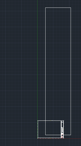

Sanket Patil Posted September 15, 2017 Author Posted September 15, 2017 Hello, Thank you for your prompt responses. Yes, I get that, but basically I have changed my job and at this current workplace they purchased Autocad Electrical, so working on things from scratch. Sorry if my questions sound silly. But I appreciate your help.. Ok, one quick question: can you tell me how can I change the length and width of the complete block (not the tittle block) so that I can fit my drawings in it ? Drawing4.dwgFetching info... Quote
Sanket Patil Posted September 15, 2017 Author Posted September 15, 2017 Please see the attached picture Quote

ReMark Posted September 15, 2017 Posted September 15, 2017 You would have to scale the entire title block along with its border OR as I suggested previously use one of the other methods I suggested. The problem is the title block and border are in landscape orientation and you appear to want the cabinet drawn vertically and not shown on its side. If a template is not available with a portrait orientation then you would have to create one either from scratch or borrow as much as you can from the default template and when completed save it as a new template file not a .dwg file. Personally, I'd draw the cabinet in a horizontal position (lying on its left side) retaining the landscape orientation of the template. Rough guess regarding a scale factor: 7.5 but I'm not sure that would be acceptable in a metric based system. Quote
