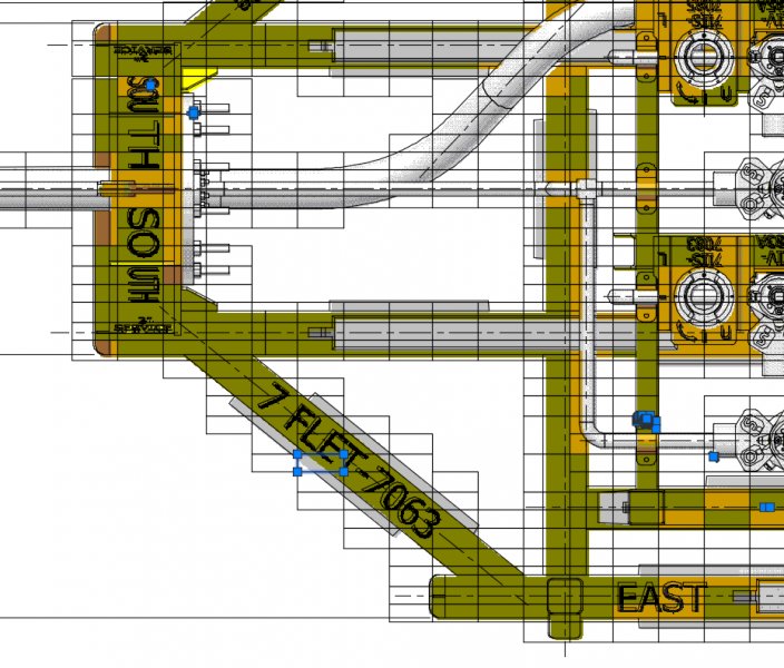

cat3appr Posted September 14, 2017 Posted September 14, 2017 Hello, I have conferted a PDF to DWG, the result can be downloaded here https://pdf.sharecad.org/files/2017.09.14/1AM9jS/J80327A-A-DW-00522_Z1_UK-EDR-00-GEN1-101337_02%20(Adobe%20signed).dwg.zip Now, as you can see, there is this annoying grid on top the DWG, I tried to get rid of it but it erases actual pieces of DWG... is there a way to remove it and have the structure underneath nice and clean? cheers! Alex Quote

ReMark Posted September 14, 2017 Posted September 14, 2017 Aren't those lines on the locked layer 22E6B38? The conversion has generated a "drawing" that will be frustrating to work with. Quote
cat3appr Posted September 14, 2017 Author Posted September 14, 2017 ReMark said: Aren't those lines on the locked layer 22E6B38? The conversion has generated a "drawing" that will be frustrating to work with. Layer 22E6B38 can be unlocked, the problem is that everything else is on that layer, that's why I'm here for help. if there is a quick fix. Quote

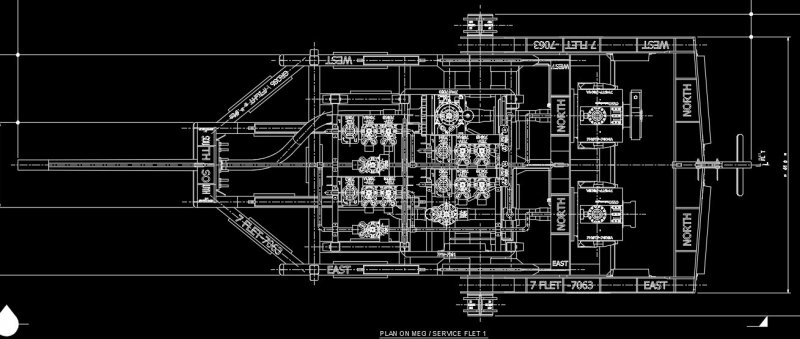

ReMark Posted September 14, 2017 Posted September 14, 2017 I may have come up with a solution. How's this look? Quote

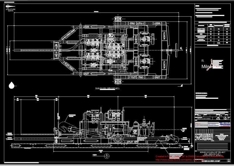

ReMark Posted September 14, 2017 Posted September 14, 2017 What the whole drawing looks like... Quote

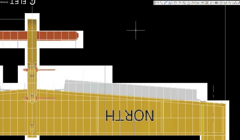

cat3appr Posted September 14, 2017 Author Posted September 14, 2017 ReMark said: I may have come up with a solution. How's this look? [ATTACH]62160[/ATTACH] It looks great I tried a few online PDF DWG converter but the first one got me the result I showed and the second one is similar to yours but the lines are all thicker.. it seems yours looks better, but is there a way to keep the hatches? all the colors as they appear? Quote
ReMark Posted September 14, 2017 Posted September 14, 2017 I did what you originally asked for and that's about all I can do. I am not a magician. Sorry. Quote
cat3appr Posted September 14, 2017 Author Posted September 14, 2017 ReMark said: I did what you originally asked for and that's about all I can do. I am not a magician. Sorry. thanks but not completely, as the hatches are lost. I'll need to find a a way Quote

hakmawongzi Posted September 14, 2017 Posted September 14, 2017 Raster and graphic will not convert so there is nothing anybody can do about it. Quote
f700es Posted September 14, 2017 Posted September 14, 2017 hakmawongzi said: Raster and graphic will not convert so there is nothing anybody can do about it. BINGO! I tried a few different ways. One I did with current Adobe Illustrator and while it did convert the PDF to DWG it also exported EVERY jpg with the file (color and fill). In the end I got 3,502 jpgs in the folder! It did however keep all of the jpgs attached to their original position. The 2nd way was to use AutoCAD 2018 Raster Design. It brought in the PDF and convert it to DWG for me. A much better solution than using Illustrator for sure. The Adobe DWG was 5.8mb in size while the AutoCAD Raster DWG was 1.046mb. I think we also need to look at how the PDF was created, which do not know. Was it a CAD program or an illustration program and what PDF print driver was used? Quote
Ski_Me Posted September 20, 2017 Posted September 20, 2017 ReMark said: I may have come up with a solution. How's this look? [ATTACH]62160[/ATTACH] OMG Remark all you did is import the pdf and had autocad convert it. I may have come up with a solution my behind. The only way this works if you have a vectored pdf which this is. Your profile shows your using AutoCAD 2011 you need to think about getting you company to upgrade to 2018 then you too can convert your PDF's without having to use a crappy converter you get off the internet. Unfortunately this pdf does not have layers so anything that is a hatch or a fill will be lost and even then I'm not sure if you could get those to convert anyway. Whenever you convert a pdf there will always be some work you will have to do. Quote
