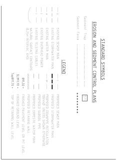

ALLI Posted January 14, 2009 Posted January 14, 2009 Hi everyone, I hope the Festive season treated everyone well:D . Now back at work I have gone from using 2004 to 2009, we use a linetype for sediement fences in 2004 which is a line with a solid square centred on the line at regular intervals, well in 2009 it just comes up as a crazy line. Does anyone have a solution or a linetype like I'm using, HELP!!!!!!!!!!!!!!!! Quote

ALLI Posted January 15, 2009 Author Posted January 15, 2009 the linetype is in a default drawing, and can't work out how to open it to edit and see how it is made up. Quote
