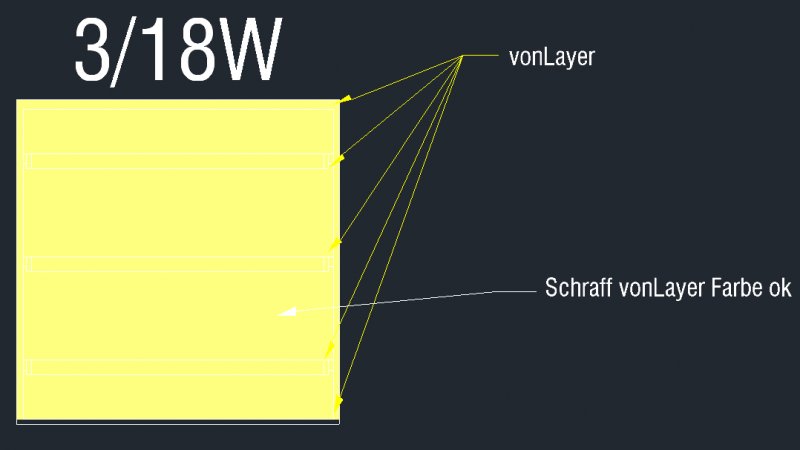

dober Posted July 18, 2012 Posted July 18, 2012 Hello How would that go if everything is on layer 0 only the hatching remain as it is. Thank you Hallo Wie würde das gehn wenn alles auf Layer 0 nur die Schraffur soll bleiben wie sie ist. Danke Quote
Lee Mac Posted July 18, 2012 Posted July 18, 2012 Hi dober, To exclude Hatch Objects from the layer change, use the following program with my LM:ApplytoBlockObjects function: (defun c:test ( / s ) (if (setq s (LM:ssget "\nSelect Block: " '("_+.:E:S" ((0 . "INSERT"))))) (LM:ApplytoBlockObjects (vla-get-blocks (vla-get-activedocument (vlax-get-acad-object))) (cdr (assoc 2 (entget (ssname s 0)))) '(lambda ( obj ) (if (not (eq "AcDbHatch" (vla-get-objectname obj))) (vla-put-layer obj "0") ) ) ) ) (princ) ) ;; ssget - Lee Mac ;; A wrapper for the ssget function to permit the use of a custom selection prompt ;; ;; Arguments: ;; msg - selection prompt ;; params - list of ssget arguments (defun LM:ssget ( msg params / sel ) (princ msg) (setvar 'nomutt 1) (setq sel (vl-catch-all-apply 'ssget params)) (setvar 'nomutt 0) (if (and sel (not (vl-catch-all-error-p sel))) sel ) ) Remember to Regen to see the changes. Quote
dober Posted July 18, 2012 Posted July 18, 2012 (edited) Thank you Lee has been running Danke Lee läuft schon Edited July 18, 2012 by dober Quote
