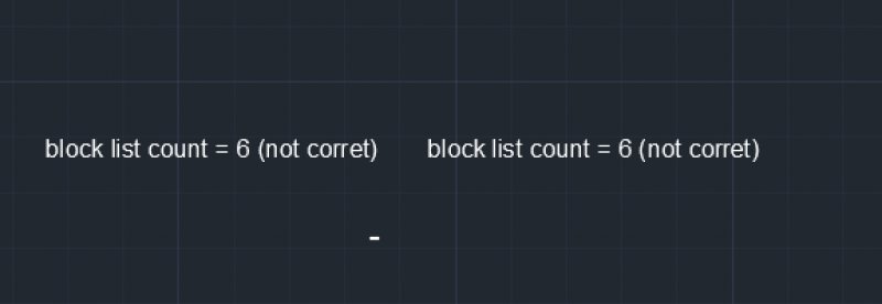

zoom extent:

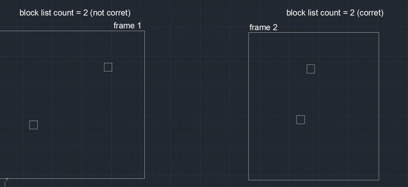

zoom out:

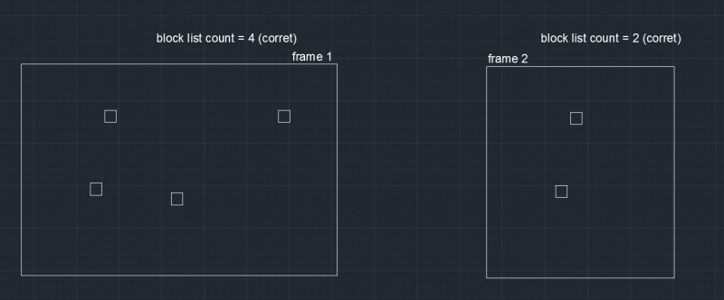

zoom out,zoom out,zoom out:
