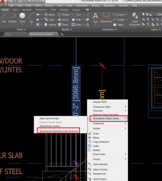

Dana W Posted September 13, 2017 Posted September 13, 2017 Yea but you still have to place them in correct spot. Id rather do it once. Wish Sync object scale location would solve this problem. Dont really even know how to use that tool. Nvr does anything for meWith the modelspace annotative view scale set to the scale where you would like the positions to align to, select the annotative objects you want synced up, then click to sync. All scale positions of the selected items will jump to the position of the current item. Of course you then get multiple ghost images of each scale in one spot whenever you select one of the items. This causes visual nightmares when doing modifications. That is why I NEVER assign more than one scale to dimensions for any one viewport, and apply or edit those dimensions only with the modelspace view scale adjusted to match the scale in the intended viewport. Quote

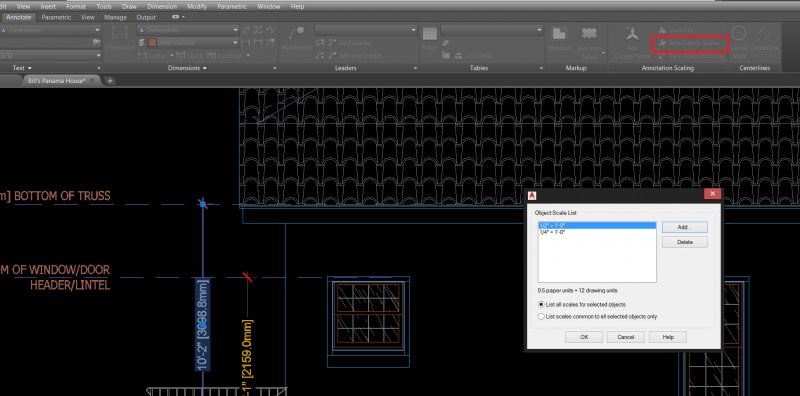

Dana W Posted September 13, 2017 Posted September 13, 2017 Sync (...hronize multiple...) On the right click menu, or on the annotative ribbon tab, right under the Add/delete, or command ANNORESET. You can only get rid of the ghosts by actually removing superfluous scales from the annotative objects by making use of Add/Delete scales either same right click menu item, or the annotative tab on the ribbon, or command OBJECTSCALE. Sorry, the ribbon grays out when the dialog box is open. If you delete a scale that is used someplace, it will no longer show up there, of course. If you have to have more than one scale assigned to an item, the ghost must remain. I am willing to bet that most of the ghosting comes from users leaving the Automatically Add Current Scale option turned on when it is not needed. I have discovered that the right click add/delete will sometimes crash with a continue option when doing the operation on multiple items, especially when selecting multiple types, like mleaders, dimensions and mtext all at the same time. For some reason the ribbon Add/Delete lets you get away with far more shenanigans of that sort without crashing. I believe it is the difference between the commands OBJECTSCALE and _OBJECTSCALE Quote

Dana W Posted September 13, 2017 Posted September 13, 2017 ...As far as add/delete scale, I use properties pallete and never have a problem. As far as ribbon, u mean right click on anno scale to get to add/delete screen, right? I do not have any thing to take me dirrectly tthere.No, I mean the right click cursor menu OR the annotative tab on the ribbon... No Ribbon, ok then. Quote
Dana W Posted September 13, 2017 Posted September 13, 2017 I still do not know what the sync even does.Apparently it is doing exactly the opposite that you want it to do. It synchronizes all the annotation objects (selected) to be the same proportional shape and position as the one(s) selected for the command. The only difference is the size determined by the view scale. Say you have a dimension with 1/2" = 1'-0" and 1/4"= 1'-0" scales assigned to it. In the 1/2" viewport you have the dimension on the right side of an object, and in the 1/4" viewport you have moved the same dimension (after changing the MS view scale) to the left side of the same object. If you select the 1/2" scale dimension in modelspace and sync it (ANNORESET), then the 1/4" scale version of the dimension will move to be exactly on top of the 1/2" scale dimension but retaining it's view scale of 1/4". If you select the 1/4" version first, then the 1/2" scale dim will move. I am not sure why ANNORESET is useful. I have usually gone out of my way to move dimensions or leaders in smaller scale views due to fitment issues. The last thing I need is for them to move back. Quote
