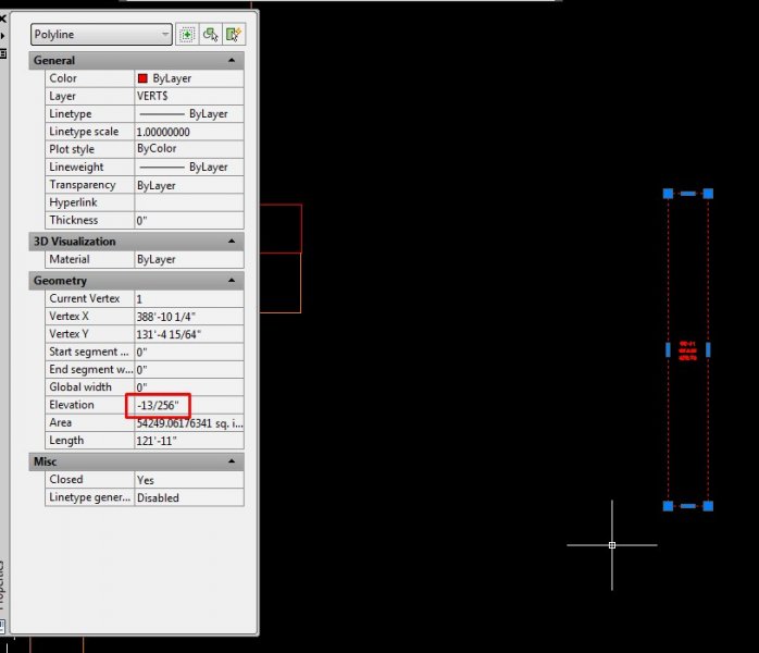

f700es Posted September 7, 2017 Share Posted September 7, 2017 FML! I was updating some department boundaries today for a financial report. Some of the boundries that were put in by a coworker needed to be edited and I kept getting non-complainer errors on the existing plines. I selected the existing plines and looked in the properties window and it said it was "0". So on a hunch I upped the units to 1/256" and then checked them again....JFC! Elevation = "-13/256" I just don't know you even do that. Quote Link to comment Share on other sites More sharing options...
rkmcswain Posted September 7, 2017 Share Posted September 7, 2017 Either ELEVATION = non-zero -or- someone took a non-zero elevation polyline and used is as their template for all others (copying it around). Other than that, it would take some work and maliciousness. Quote Link to comment Share on other sites More sharing options...
BIGAL Posted September 8, 2017 Share Posted September 8, 2017 When is zero not zero when its 0.6E-13 recent post. Quote Link to comment Share on other sites More sharing options...
