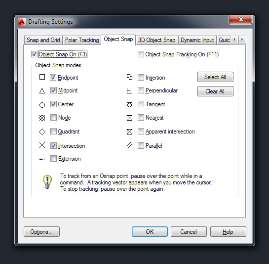

Cad64 Posted September 7, 2017 Posted September 7, 2017 Do you have 'Midpoint' enabled in your Osnap settings? Quote
Cad64 Posted September 7, 2017 Posted September 7, 2017 Type OSNAP at the command prompt. This will open up the "Drafting Settings" window. Make sure you're on the "Object Snap" tab and then enable the object snap modes that you want to use, (see image below). Click "OK" and you should be ready to go. Quote
PJ01 Posted September 7, 2017 Author Posted September 7, 2017 Many thanks for this very helpful reply, CAD64, much appreciated. Worked perfectly. Strange, in any of the rectangles I have drawn, the SNAP was not switched ON ( F9 key), but after doing as you suggest, it now finds the mid point, even though I am still not using SNAP Quote
