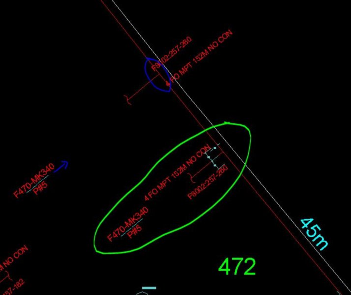

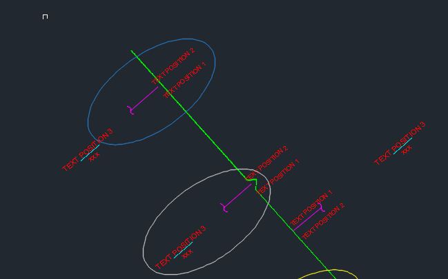

...one more help required, if u refer the attached image, the yellow circled region shows the manually aligned for showing it in readable anglet

Thanks you so much for your help again, i tried with your new code, but it resulted like text1 & text2 getting moved to start point of that block as shown in attached image(blue circled location), could you please look on that. Thanks

Thank you pBe for your reply....sorry for late reply from my side as i was in vacation........ i tried with your revised lisp(> ang (* 0.5 pi))) pi 0)), its now getting changed to readable angle, but the problem is texts(site anno & count anno) not getting aligned in proper position as shown in attached image(blue circled locations)....my requirement is like to be get aligned(as in green circled part).....also attached .dwg for your reference

The problem is tied into an extra question is the text left or right orientated compared to the block ? I know in my code I used a fudge factor to position the text. Using the insertion point of the block, now need to look at the bounding box of the block, length of text characters and so on. Often a simple answer becomes a lot more involved. You may need more than 1 version of the code. Normally you keep the majority of it making a defun and then do the adjustments like L or R adding to it.
The code supplied matched exactly your initial request so for me to start adding options it would be better to start again and write it to be more universal and work with any block and word lengths as a start.
Sorry no code.
Like the prior post an attributed block would be a simpler way to go maybe at least 2 versions a left and right. Can still attach the existing text to a new block very easy, diferent lisp.

Thank you so much Bigal for your Help......i tried as per suggestion its working fine now..............thank you so much for your help.
