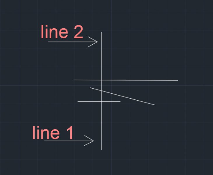

ursan Posted August 27, 2017 Posted August 27, 2017 Hello I know that ı am able to find a point where two lines are intersected eachother with this command '"object1.IntersectWith(IntersectObjects, ExtendOption)" Dim mainLine As AcadLine Dim line1, line2,line3 As AcadLine i have mainline information. ı want find other lines which are intersected with the main line . for example line1,line2 and line3 are intersected with main line, ı want to find these lines. Quote

ursan Posted August 28, 2017 Author Posted August 28, 2017 I wrote an example for you VBABut you do not see my example ? I saw your example. But when the lines have different angles they do not find all the lines. Quote

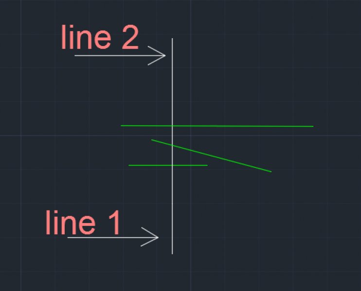

RICVBA Posted August 29, 2017 Posted August 29, 2017 here's a possible code Option Explicit Sub ListIntersectingLines() Dim linesSset As AcadSelectionSet Dim nIntersectingLines As Long Dim mainLine As AcadLine, acLine As AcadLine Set mainLine = GetALine If Not GetPossiblyCrossingLines(linesSset, mainLine) Then MsgBox "no possible intersecting lines with main line" Exit Sub End If If FilterActuallyIntersectingLines(linesSset, mainLine) Then For Each acLine In linesSset nIntersectingLines = nIntersectingLines + 1 MsgBox "Intersecting line #" & nIntersectingLines & " ID=" & acLine.ObjectID acLine.color = acGreen Next Else MsgBox "no intersecting lines with main line" End If End Sub Function FilterActuallyIntersectingLines(linesSset As AcadSelectionSet, mainLine As AcadLine) As Boolean Dim nLines As Long Dim acLine As AcadLine Dim removeObjectsCounter As Long ReDim removeObjects(0 To linesSset.Count - 1) As AcadEntity With mainLine For Each acLine In linesSset If UBound(.IntersectWith(acLine, acExtendNone)) = -1 Then Set removeObjects(removeObjectsCounter) = acLine removeObjectsCounter = removeObjectsCounter + 1 End If Next If removeObjectsCounter > 0 Then ReDim Preserve removeObjects(0 To removeObjectsCounter - 1) As AcadEntity linesSset.RemoveItems removeObjects FilterActuallyIntersectingLines= linesSset.Count > 0 End If End With End Function Function GetALine() As AcadLine Dim basePnt As Variant On Error Resume Next Do While GetALine Is Nothing ThisDrawing.Utility.GetEntity GetALine, basePnt, "Select a line" Loop End Function Function GetPossiblyCrossingLines(linesSset As AcadSelectionSet, mainLine As AcadLine) As Boolean Dim gpCode(0) As Integer Dim dataValue(0) As Variant gpCode(0) = 0 dataValue(0) = "LINE" On Error Resume Next Set linesSset = ThisDrawing.SelectionSets.Add("Lines") On Error GoTo 0 If linesSset Is Nothing Then Set linesSset = ThisDrawing.SelectionSets.Item("Lines") Dim corner1 As Variant, corner2 As Variant mainLine.GetBoundingBox corner1, corner2 ZoomWindow corner1, corner2 With linesSset .Clear .Select acSelectionSetCrossing, corner1, corner2, gpCode, dataValue If .Count > 1 Then Dim removeObjects(0 To 0) As AcadEntity Set removeObjects(0) = mainLine .RemoveItems removeObjects GetPossiblyCrossingLines= True End If End With ZoomPrevious End Function Quote

RICVBA Posted September 10, 2017 Posted September 10, 2017 it 's because overlapping lines won't have IntersectWith() method catch any intersection points you could handle this exception by trying and see if any line parallel to the main one is overlapping (hence intersecting) also in many ways here is one of them (only showing changed subs/function): Function FilterActuallyIntersectingLines(linesSset As AcadSelectionSet, mainLine As AcadLine) As Boolean Dim acLine As AcadLine Dim removeObjectsCounter As Long ReDim removeObjects(0 To linesSset.Count - 1) As AcadEntity With mainLine For Each acLine In linesSset If Not DoesItIntersect(mainLine, acLine) Then '<--| have a specialized function detect "true" intersection Set removeObjects(removeObjectsCounter) = acLine removeObjectsCounter = removeObjectsCounter + 1 End If Next If removeObjectsCounter > 0 Then ReDim Preserve removeObjects(0 To removeObjectsCounter - 1) As AcadEntity linesSset.RemoveItems removeObjects End If End With FilterActuallyIntersectingLines = linesSset.Count > 0 '<--| note I changed this line position End Function Function DoesItIntersect(mainLine As AcadLine, currentLine As AcadLine) As Boolean Const PI = 3.14159265358979 If UBound(mainLine.IntersectWith(currentLine, acExtendNone)) = -1 Then If Round(mainLine.Angle - PI * (mainLine.Angle \ PI) - (currentLine.Angle - PI * (currentLine.Angle \ PI)), 4) = 0 Then ' if the passed line is parallel to the main one Dim endPoint As Variant endPoint = currentLine.endPoint endPoint(0) = endPoint(0) + 0.01 ' spot a point a little shifted from the current line end point With ThisDrawing.ModelSpace.AddLine(currentLine.StartPoint, endPoint) ' draw a line with current line start point and the "shifted" end point DoesItIntersect = UBound(.IntersectWith(mainLine, acExtendNone)) >= 0 ' if it intersects the main line then the current line overlaps it .Delete End With End If Else DoesItIntersect = True End If End Function Quote
