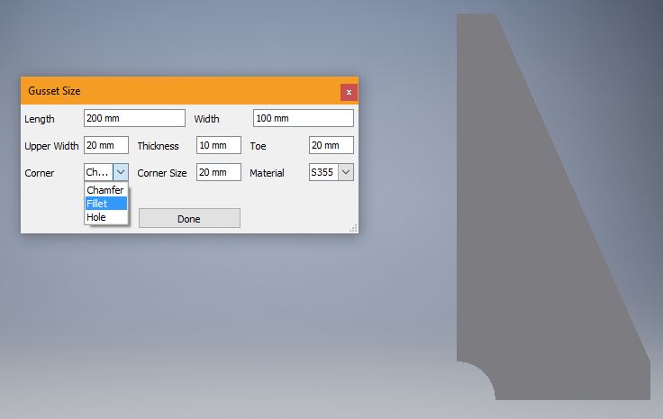

I am working on an iLogic form where i can define the size of a gusset plate as shown in the picture.
I am stuck at one point where i want a combo box in ilogic form with 3 options (chamfer, fillet and hole). And that will define which feature is active and make other 2 features suppress.
Making a combo box is not a big deal but I am not able to find an ilogic rule where i can say that 'if feature A is active then feature B and C are suppressed.
Any solution for above?
Thanks in Advance

Something like this should work:
'suppress all 3 features at first
Feature("Feature A").IsActive = False
Feature("Feature B").IsActive = False
Feature("Feature C").IsActive = False
'activate relevant feature
Select oFeature
Case A
Feature("Feature A").IsActive = True
Case B
Feature("Feature B").IsActive = True
Case C
Feature("Feature C").IsActive = True
End Select
