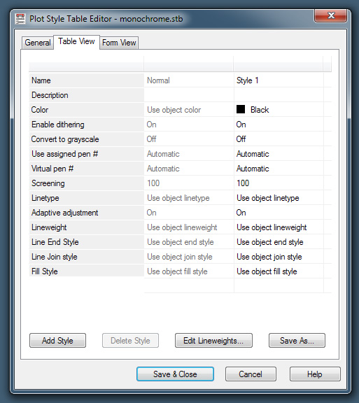

oftenly Posted August 17, 2017 Share Posted August 17, 2017 (edited) Simple question that is killing me softly. Why is this button grey? I finally figured out how to get a .stb file working, and now this. Thanks for the help! Edited August 17, 2017 by oftenly Quote Link to comment Share on other sites More sharing options...

oftenly Posted August 18, 2017 Author Share Posted August 18, 2017 It's set to 0, which apparently means named plot styles, which is what I want. I went through all the steps to convert my monochrome.ctb style to a .stb one, and applied it, and so I'm at the point where I should be able to create a bunch of different styles and apply them to different layers. I just can't add styles, and all my internet searches come up with nothing. What could I possibly be missing? Quote Link to comment Share on other sites More sharing options...
Dana W Posted August 18, 2017 Share Posted August 18, 2017 You can edit the one you have selected at the moment and hit the Save As button. Quote Link to comment Share on other sites More sharing options...
Cad64 Posted August 18, 2017 Share Posted August 18, 2017 I went through all the steps to convert my monochrome.ctb style to a .stb one, and applied it Why did you convert your monochrome.ctb style to a .stb style? Autocad ships with a monochrome.stb plot style already set up, so there is no need to convert anything. If you open the standard monochrome.stb file that should be located in your Plot Styles folder, you will see that the "Add Styles" button is available, (see image below). I'm guessing maybe something went wrong when you converted your .ctb file? Quote Link to comment Share on other sites More sharing options...
