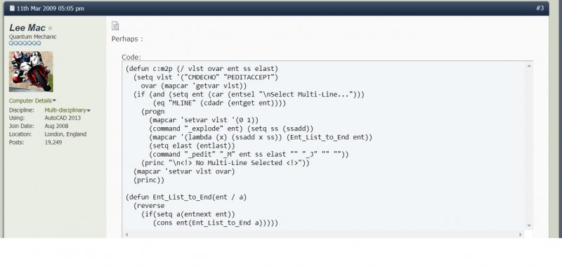

isutheparambil Posted August 15, 2017 Posted August 15, 2017 Hi, I am looking for a lisp that can convert MULTILINE to a single PLINE. The lisp that converting the same MULTILINE to 2 PLINE already I found from the attached post. But I need that multi line in to a single pline-NOT double pline. If someone have any idea, please share with me... :) Quote
