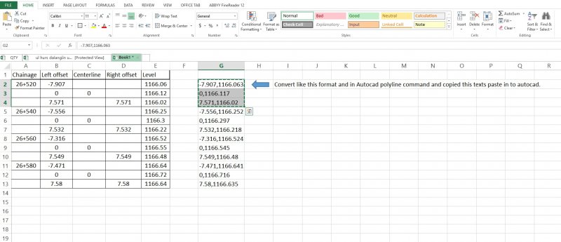

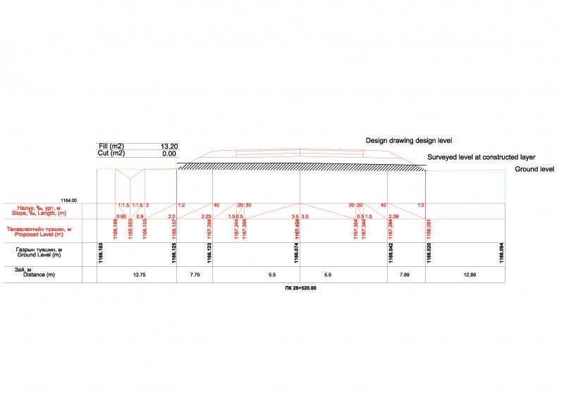

First we have road cross section drawings by dwg. format. Its already drawed by consultant company. Then our surveyors check the constructed embankment layers. And we need to draw that level on the cross sections. And pick up constructed embankment areas from drawings. Cross sections are every 20m. Its mean so many cross sections there.
My using method for draw layer and pick up quantities is.
First I have some surveyed points that including center line and both side offset. Minimum 3points of surveyed.
How I quick do those steps. Any method for that?

I attached sample cross section that we draw every 20meter and on every week. Its too much time spending draw one by one.
And I have surveyed points that at the constructed layer. My drawing steps are
1. cntl+a select all cross section drawing
2. m-move command pickup center line top level and move to (0, center line level)
for example 0,1167.424 its in sample cross section that I attached.
3. pl-polyline command and copied from excel offset and levels
4. paste into autocad command line
5. pickup area of cross section
its my steps to drawing cross section one by one
Its probably time to look at CIV3d or "Civilsite Design" www.civilsurveysolutions.com.au it will do a full report of your road design even broken down into the different volumes of pavement material and at a press of a button.
I am sorry but to me spending hours writing code would be a waste of time when the ability to do this has been around since the 70's, you will recover your cost outlay so quick using other stuff in the package.
Civil 3d, civil site design its all same software for only design drawing and it can do quantity estimation.
But my thread is for different situation. Already have some cross section from design software but we need to merge our constructed levels into that cross section and need to pickup quantity
