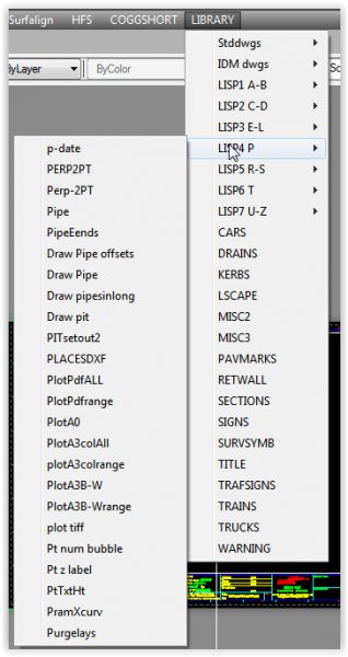

We use menus for our lisps these can have sub menus as well. Sounds safer than using a DCL.

A mnu file is just a text file nothing fancy, this is a cut down version of the image but includes 2 sub levels as example. This includes using images for selections.

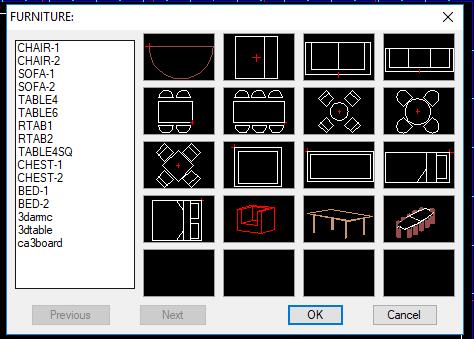

Image from menu could be used to choose which lisp to run. Also look at (if (not yourdefun)(load "yourlisp")) stops the lisp loading again.
Thanks BigAl, that's more than I expected, much appreciated though
I am going to copy this and play around with it over the next few days, and no doubt when it all confuses me I will pop up again to ask for some help
No probs the image stuff needs a lot more explanation, the image is default out of the box but you can do custom dcl say 3x3 4x3 panels etc with images a bit more complicated but still easy when examples are provided.

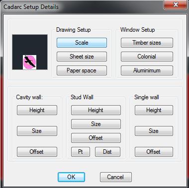

Something else using sub menus in dcl
