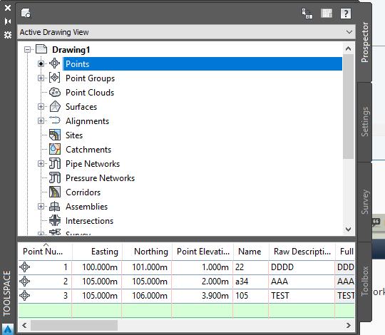

BIGAL Posted September 2, 2017 Posted September 2, 2017 (edited) There is a way around this just tried it you can have points like A1 A2 etc but they will be automatically numbered but the A1 will be assigned to "Name" other quirk is it makes A to be "a1" not sure why lowercase. Tried 22A but still 22a. You can then Have "Name" as part of a lable style. "Point file format" Style is Name,E,N,Z,D 1,100,100,1.0,pt1 A2,110,100,1.2,pt2 3,120,100,1.3,pt3 a5,120,120,1.0,pt5 a6,90,120,0.8,pt5 B27,99,99,1.4,pt6 Edited September 2, 2017 by BIGAL Quote

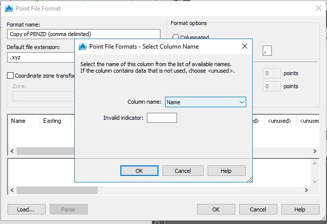

awoehl Posted September 14, 2017 Author Posted September 14, 2017 there is a way around this just tried it you can have points like a1 a2 etc but they will be automatically numbered but the a1 will be assigned to "name" other quirk is it makes a to be "a1" not sure why lowercase. Tried 22a but still 22a. You can then have "name" as part of a lable style. "point file format" style is name,e,n,z,d 1,100,100,1.0,pt1 a2,110,100,1.2,pt2 3,120,100,1.3,pt3 a5,120,120,1.0,pt5 a6,90,120,0.8,pt5 b27,99,99,1.4,pt6 How do i get the point file format to include name? Quote
BIGAL Posted September 15, 2017 Posted September 15, 2017 I will find it again its a setting something like "Turn Name on", hidden in the 1001 styles hint manual that I can not find again. Still working on my degree in Styles. 22,100,101,1.0,DDDD A34,105,105,2.0,AAA 105,105,106,3.9,TEST Quote
