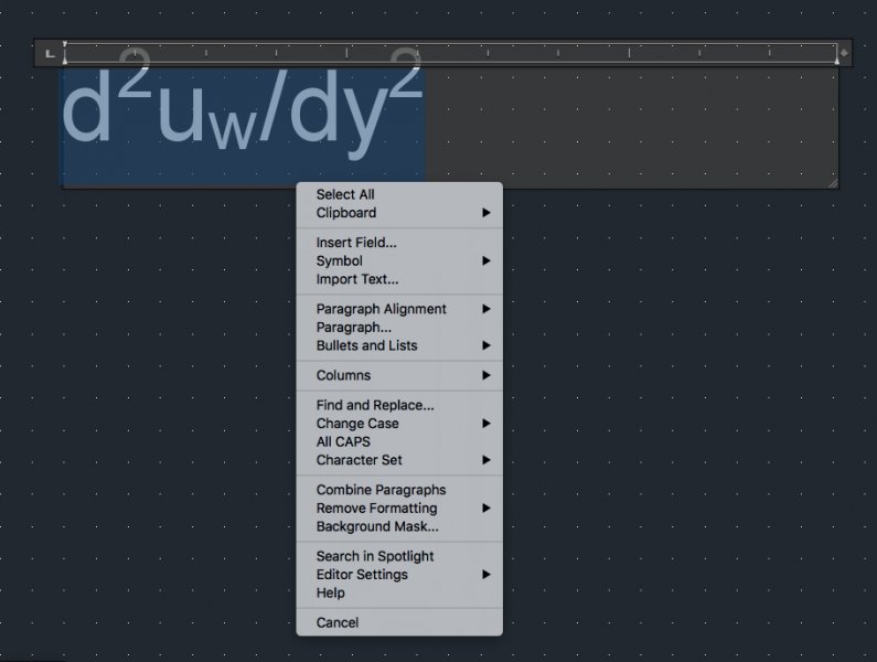

HC2020 Posted July 31, 2017 Posted July 31, 2017 Hi Guys I'm new to this website .. I've been trying to write d2uw/dy2 in AutoCad 2016 (Mac), this is the second derivative of of uw over y. Now d2uw (2 is superscript and w is subscript) is straight forward (using ^ and staking option), **Problem is I can't write d2uw / dy2 in a horizontal fraction format**. Anyone has an idea on how you can superscript, subscript and have it all in a horizontal fraction ? Many thanks in advanced HC2020 Quote

HC2020 Posted July 31, 2017 Author Posted July 31, 2017 Can we see an image of what you are getting as a result? Thanks for your reply ReMark; Please find attached image; I'm trying to have the whole thing in a horizontal fraction but I can't see 'stack' option when I right click! /Users/ci1ma/Desktop Quote

HC2020 Posted July 31, 2017 Author Posted July 31, 2017 Did you forget to attach the imagine? Sorry guys, image attached this time! I'm trying to have the whole thing in a horizontal fraction but I can't see 'stack' option when I right click as shown by the image. Quote

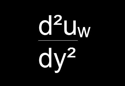

ReMark Posted July 31, 2017 Posted July 31, 2017 I don't think it is possible. I'd suggest writing the upper and lower portions of the derivative as two separate text entities separated by a line. Or would this work? I did it using MText (two lines & underline the first three characters of the top). Quote
