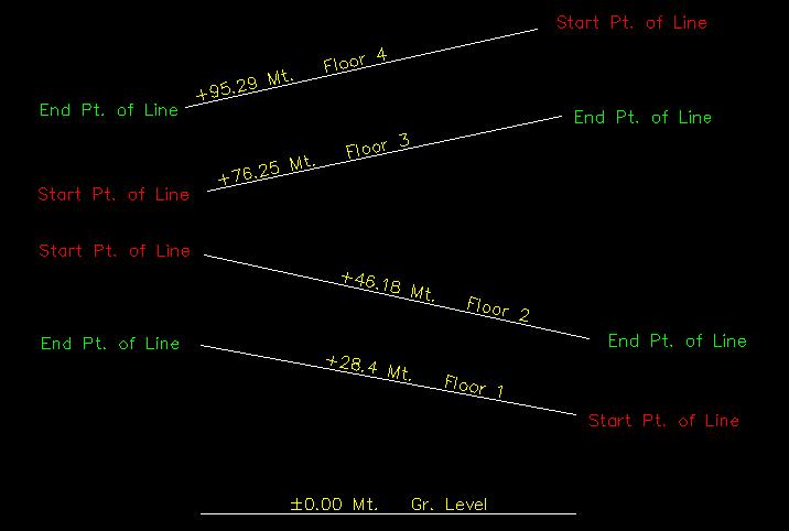

The above will prompt for the selection of a Ground Floor line (either 2D polyline or Line) and then continue to prompt for subsequent floor level selections and names. The Levels can be at any angle, and, if not parallel, the distance will be to the closest point.
See example attached.

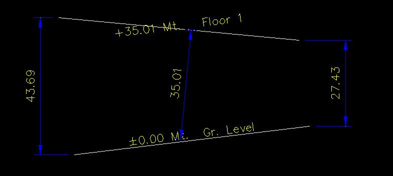

Edit to my original post:
The point is measured from the midpoint of the ground floor line - thus, if the lines are not parallel, the distance measured will be the closest to the midpoint, not to the line.
Also, if the lines are not parallel, the text will be set at the angle of the base line, not that of the top line - I shall endeavor to fix these bugs.
Ok, So I have accounted for the subsequent floors not being level. - takes quite a bit of playing around with the angles and conditional statements depending on the angle of the floor level, but I got there in the end..
The hard part is that the floor lines can be drawn from either side, and so the angle measured is either say, "x" when drawn from left to right or (x + pi) when drawn from right to left.
See example for how I have overcome this. - again though, distances are measured from the midpoint of the ground floor line - to the closest point on the floor level (i.e. the perpendicular).

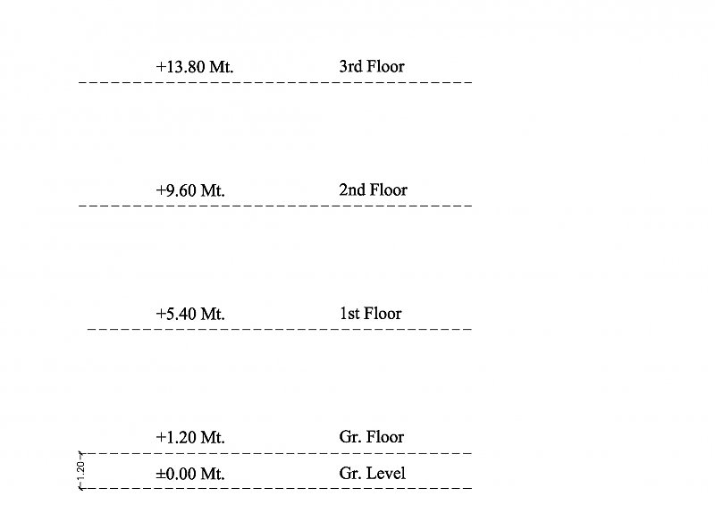

i load the lisp file but problem is text insert is middle of line
& some file text rotate in 180 dgree
and onter help
chage floor height manual change the every floor height
define text layer, text height & text style
im using autocad 2008 & 2009
sorry for bad english
thnx

Did you load the newly posted LISP? ~ as shown in the example, all works fine on my machine.
As for changing one floor height and needing to change every floor height, this shouldn't be the case as all the height are measured from the ground floor +/- 0.00 and are not relative, - you should only need to re-do one floor.
As for the layers and text heights and styles, these can all be changed very easily - what do you require?
