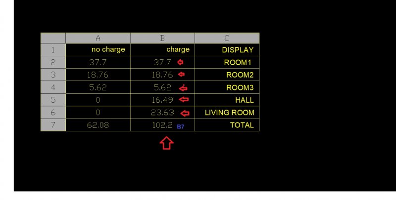

i looking for lisp that can calculate a sum of cells by clicking on the cell i want.
i have many tables that i have to make sum for every colum
and its difecult to do this foe every table
some openion ??!!

I WANT SUM ALL THE COLUM TO THE CELL BELOW "TOTAL"
the table not always 7 rows it may any numbers of rows
its good . but i want it sum to autocad not an external windows
and write the sum in the cell i want
