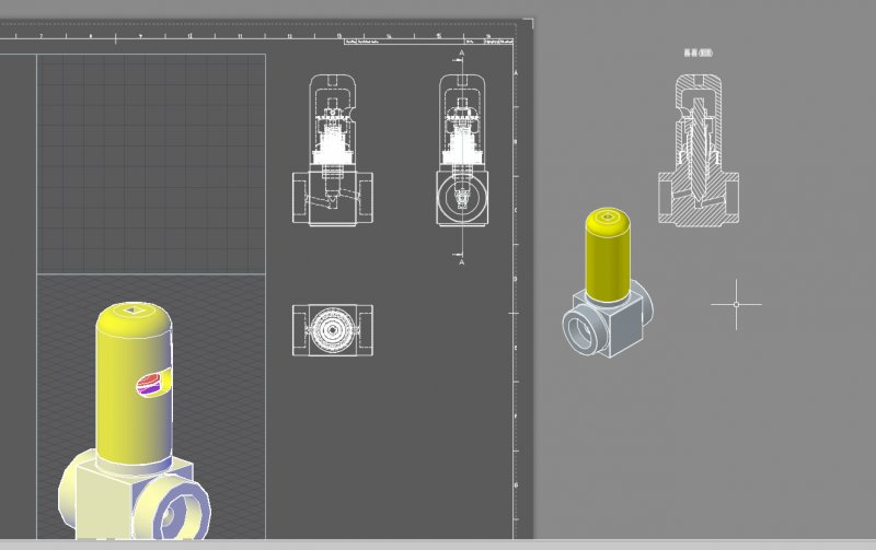

couves Posted July 10, 2017 Posted July 10, 2017 I need some help from somebody if possible. I can't do a section plane on my drawing. I want to do cut my drawing in half but it says inconsistence edge face relationship. and doesnt do nothing. the file was a bit big to put it on the site so ill send a link to donwload. the file is only 3.5 mb. https://ufile.io/f07vq Quote

gazza_au Posted July 12, 2017 Posted July 12, 2017 I would do this in paperspace using viewbase then view section commands, see attached s.s. Once you have placed your views using viewbase, select the required view then draw a line through the view you wish to section. Then use the viewsection command to select that view and draw over the line, then right click and enter and place you sectioned view. You can then edit the hidden lines etc. Quote

couves Posted July 13, 2017 Author Posted July 13, 2017 Good Morning. Thanks for the help gazza it worked in layout. I managed to do it like you said. 1 question is there any way to do a section cut but intead of it being in 2D, make a cut in 3D? Quote
gazza_au Posted July 13, 2017 Posted July 13, 2017 Use VIEWPROJ on your already sectioned view, move all the other views you don't need off the screen, I do this alot in Inventor. Quote
