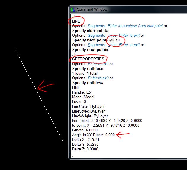

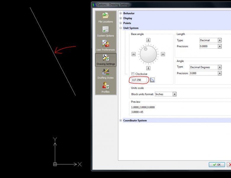

Well let me do a second test. How about a base angle of 117.356?
OK...test done. That worked too. To check I draw a line and specify @6
BTW...I can double check what angle the line is drawn at if the base angle is reset to its default of 0. Turns out the angle is 117.356 degrees.
Step 1: set base angle.
Step 2: draw line, check properties.
