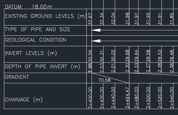

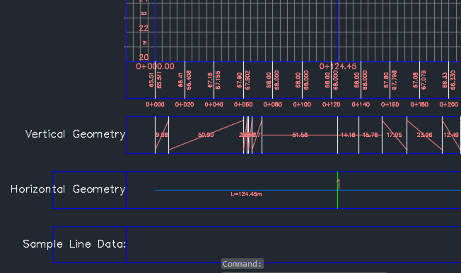

We are using Civil 3D to generate profiles of our pipe network
But the format of the profiles as given by Civil 3D is not what we require
So we have to use a lisp to manually adjust the profiles but now on Vanilla Autocad
Attached is what Civil 3D gives us and what we require.
Anyone familiar on how we can achieve what we require by using Civil 3d alone....Civil 3D Profile.PNG
